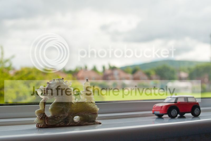

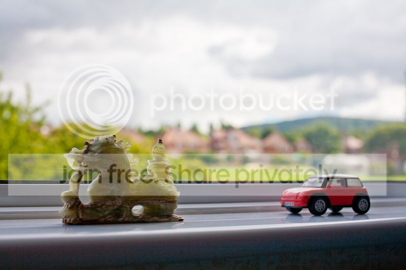

I sold my APS-C camera but I have a 5D (FF) and a G1 (MFT, x2 crop.) As the G1 is x2 the math is easier :D
I've just taken these two shots out of my window. 5D, 50mm f5. G1 25mm f2.8.
They're pretty much the same picture IMVHO and you'd have to look pretty closely to see any real difference, which would be mostly down to the lenses anyway.
Here they are...
PS. Looks like my finger slipped so the 5D shot is actually at f4.5.

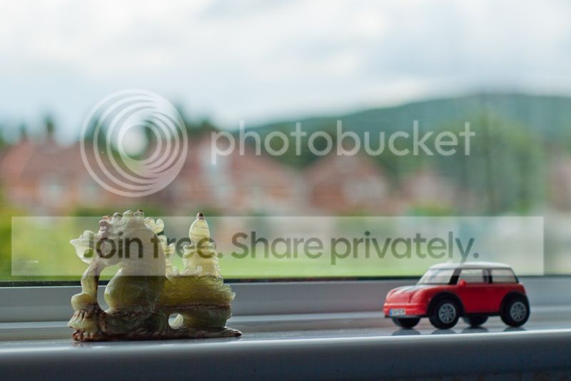

Just for fun, this is the G1 fitted with a 50mm lens at f2.8. I had to move back maybe 4 ft or so to get the dragon and car more or less the same size in the frame.
