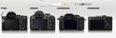

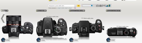

You could have a play with the camera size comparison site...
Sony A7, Nikon D3300, Panasonic G2 and GF1...
