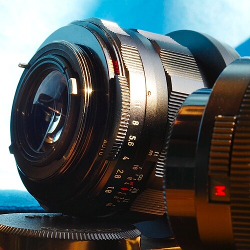

OK I'm confused. I bought a M42 zoom lens for my two Pentaxes (ME and MX), and splashed out on the proper Pentax M42 adapter, allowing infinity focus. Actually it seems to focus a bit past infinity which is kind of odd. But that's not my question...
Today as it was a nice(ish) day I took ALL my Pentax lenses and a tripod out near the Castle and tried them all (on HP5 film). It'll be interesting to see the results. The last was this M42 zoom, which I've never used before.
I know that the "wide-open meter, automatically stop down on shoot" thingy wouldn't work with the new lens. I was expecting to have to compose and focus with the lens wide open, then stop it down to meter and shoot. However, the lens appeared to stay wide open throughout, and moving the aperture ring had no effect on the (over) exposure. I set the aperture from the previous shots and took my shots anyway (perhaps I should have adjusted the speed from 1/500 to 1/1000, but I guess it wouldn't have made that much difference).
When I got back I looked more closely at the lens, thinking there might be some sort of "stop down" button, but nothing. I took the lens off the camera, and I could see that the aperture stays open unless the pin in the lens base is pressed. But there's nothing in the lens mount or the MX that will press on that pin. So I'm kind of stumped as to how the aperture is ever going to close on the K mount adapter.
Now either this lens is of an unusual design or I'm doing something stupid. I'm always inclined to expect the latter. Any ideas what I've done?
