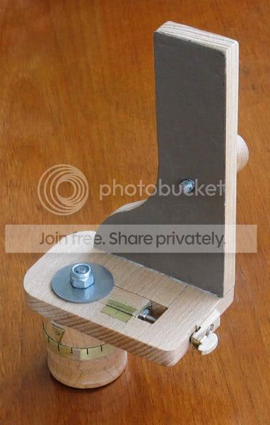

I remember it was very difficult to get a good stitch with PTAssembler to begin with. So I built myself a bracket. If you want to see click on the cross.
