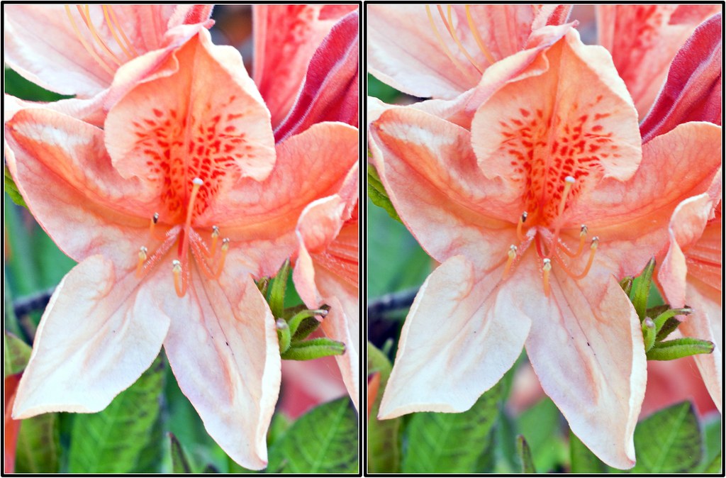

Wasn't placing the cameras a few feet apart. Granted they will be a tad wider than my eyes are apart, but that does work. I have done stereo images before, out in the wild, and have not constrained myself to a couple of inches apart. It just accentuates the stereo just a touch.
e.g.
rhodedendron by http://bendthelight.me.uk, on Flickr
e.g.

That doesn't work very well for me. I'm suspecting the wider spacing is just too much at close distance like that?
I've seen some spectacular landscapes though, grand canyon and the like, taken with cameras a few feet apart :thumbs:
Different people have differing success in seeing these anyway. It's people in the studio that I want to get if I can, and I think the size will make some difference...as it is, I have the cameras literally next to each other, so the distance between the lens's centres is probably about an inch or at most 2 inches wider than the set of the eyes. With the flower above, I recall a quite significant shift, possibly about a foot or so.

I can make it work, by doing that cross-eyed staring thing (had to reduce the size first) when it suddenly pops into 3D, but then the effect is very exagerated, looks like the flower is about a foot deep.
I'm no expert on stereo but there must be some rules/guidlines on spacing vs shooting distance?
