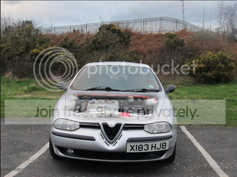

Not a complicated method particularly, more time spent messing with it the better it will look, I go for the lexan bonnet style, trying to keep reflections/bonnet shape in. I usually keep the badge solid if there is one though.
I have done a couple like this in the past. Like Digitalize said you need 2 photos from a tripod one bonnet up and one down. On photoshop have the bonnet up pic on the bottom layer and photoshop the bonnet out. I left the edges of the bonnet and use a blended eraser to get rid fo the centre of it.
