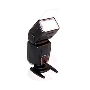

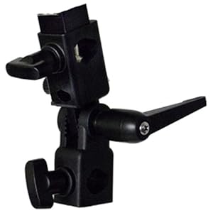

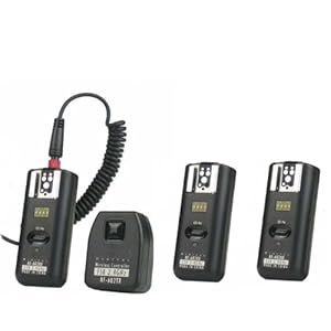

Hi guys I went on bit of a shopping spree on Amazon and dont know what to do now lol :bang: got a bit carried away and ended up buying:
2x Yonguno YN460-II
1x Yonguno RF-602 + 3 X Receivers
2x Konig Photography Light Stand
2x 33" White Brollies
2x Interfit Strobies Umbrella Holder with Hotshoe Adapter STR117
I also have a Canon 580EX II, I was going to post in talk basics section as "Absolutely no question is too silly or basic for us in here" but thought would get a better response in here...
I dont really know what my question is :thinking: I guess I want to know is firstly how to get it all working together as for some reason when I connected the two Yonguno flash guns to the recievers both had to be set to M instead S1 and S2.

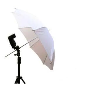

Also how should I go about using the stands and brollies? Anyone got examples of how they put it all together? Not sure I am doing it right or wrong :nuts:
im not sure if you need to set your flash to anything but usually putting it onto Manual will help. Connect the receiver to the flash and then the umbrella mount. Looks like you did that ok by the pictures.
Its a shoot through umbrella so i'd advice using it at a shoot through, that way you can get the umbrella as close as you can without being seen in frame.
The idea is that the larger the light source in relation to the subject the softer the light will be.
Where to put the light? Best way to start is hold the lightstand, stretch your arm out straight and at 45degress and plonk the light down.
Set your camera to manual, 1/125th is usually the max sync on those triggers and then a low aperture and fire a test show.
When I shoot with flashguns I generally never use them above 1/4 power as im worried about burning them out. If you find that you need more light up your ISO or lower your f number.
Remember that shutter speed doesnt affect (effect) flash, only ISO, aperture, flash power and flash to subject distance.
One more thing, since you have two flashes you could set the 2nd one as a rear hair light.
I hope that helps a little.
