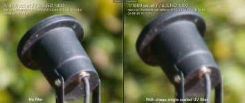

Even cheap filters will not always cause issues... the light has to be coming from the right direction (in relation to the coatings) and the scene has to have details that make it apparent. In terms of IQ/sharpness, people seldom achieve maximum anyway, so a slight loss may be imperceivable... it's like using a TC or small aperture macro; it always reduces maximum resolution, you just may not be able to tell.
This is the kind of results a cheap filter can cause... probably even a high quality one as well; you don't always get what you pay for. In this example it looks like Nisen bokeh, but the cause is different.
This is a second example from a different lens/filter combination.
