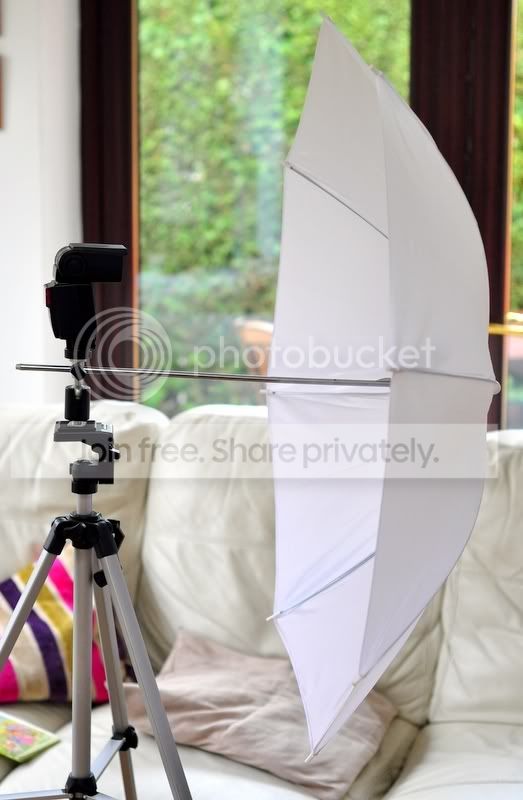

For the first time i'm doing some portrait work for a client this weekend.
I'm shooting D90+SB-600 (On and off camera), for the off camera shots i'm going to try an umbrella - just wondering are there any good tips on how to achieve best results with this set up ie :-
- Distance of flash & umbrella from subject
- Angle of flash to subject ie 30, 45, 60 degrees ?
- Umbrella point down, up or straight at subject
- Distance from flash head to umbrella
Could I even tilt the flash head up so get some bounce off the ceiling as well as through the diffusing umbrella ?
Finally is it possible to increase / decrease the flash output (on the flash unit) on the sb-600 when it's in slave mode ?
Thanks in advance,
Mike
Shoot through umbrellas are limited, because about 60% of the light goes through them and the rest bounces everywhere, making it almost impossible to control the lighting. See this article on light shaping tools.
Distance - the closer the umbrella, the softer the light will be, so choose the distance that produces the effect you want. Bear in mind that because of the light spill, you may get flare if the umbrella is between the camera and the subject, which is a major disadvantage.
Angle - whatever works for your subject and the effect you want. There are no rules.
Up, down or straight? - again, whatever works, but pointing downwards makes the eyes look bigger (because the catchlight is higher in the eye) so many people prefer this.
Distance from flash head to umbrella - just enough to ALMOST fill all of the umbrella, with no light passing by it.

As you have no reflector I'd try and position the client so the brolly can provide the key with the window providing a little bit of fill. Get that brolly as close to the client as you can and the client as far away from the background as possible. Doing this will help to control spill, soften the key light and mean you have lots of power control.
Do you have gels? A 1/4 CTO will help a lot to warm the skin. As you have no reflectors a safe position for the brolly is about 45* in front of and to the side of the face and slightly above. This should stop you getting panda eyes.
