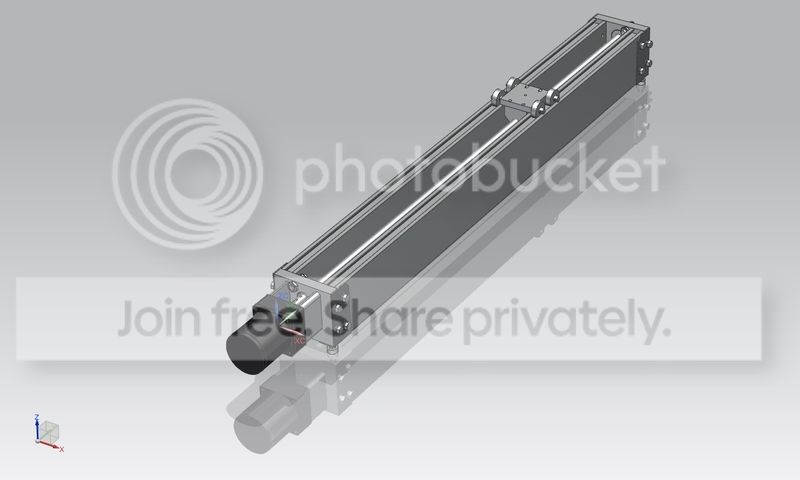

Thread from the dead! I submitted the time ticket at work for the first part today, sadly it will use a 240v motor but that's only because it was kicking about. Also uses some extruded aluminium bar that was kicking about the workshop so I'm not sure how useful the drawings would be to anyone :( I will put them up for anyone interested, and also an electrical circuit diagram. For simplicity it is just going to be constant drive, max 1 meter per hour ish but variable so it can be slowed down. Limit switches at each end to stop it destroying itself.
Also it should be able to used as a normal video rail thing with the new design - the 'kart' can be unscrewed from the leadscrew fairly easily now.
Quick render..:
Will be watching with interest as I've considered making a dolly slider myself:)
I had bought all the stuff for a slider project but never got round to it.. I found a place that did the same raw aluminium rails as dynamic perception.. I will get more details later.. I had the rail, belts, ardunio, cogs, motors.. but never built it up..
looks very interesting :) please don't forget to share with the result ( slider it self :) )

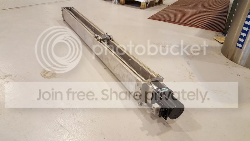

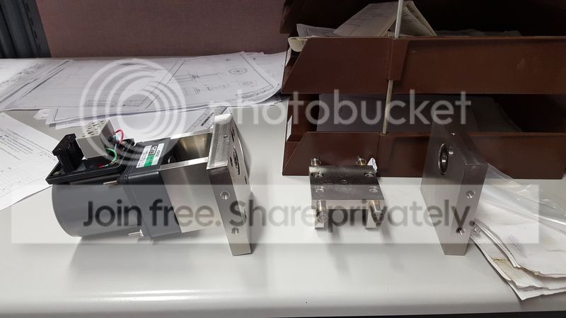

Looks good.. I wish I had that stuff kicking around d
Thanks - My job has it's perks!
how heavy it's gonna be :) ?
Quite, but not totally unmanageable. I've not weighed it but the motor isn't that light, nor are the end plates. The rails are hollow aluminium section so no real weight, it's just heavy at the ends. CofG is towards the motor of course.
Still, at least it's not going to get blown away :P
Total length inc motor is 1.7m and total run for the camera is a smidgen under 1.4m.

very nice :) i bet it's gonna be rock solid :)
that looks really good and promissing. what are you planning to use to controll it?
