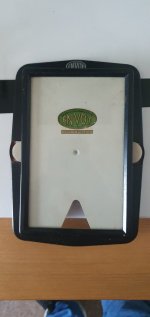

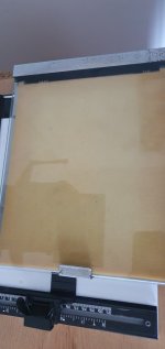

Yep, I'm back with another inane question. I got another enlarger and with it came some stuff, old paper (some of which I'll be passing along, I've not enjoyed using graded paper so far) and these things.
I'm figuring the big thingy is a contact printer though I've no idea how you'd put anything under the date and subject bits
but what the hell is that envoy thing?
Its sort of spring loaded from the back.

The top thingy is a Paterson contact proof printer, minus a lot of the part (well, it seems, ALL of the part) that held the negatives. When used as built and intended, the negatives were contact printed with the Subject Date etc. as headings to write on; frame numbers (if 35mm) appeared with the strips. Mine are filed with the negative sheets so I can find a negative pretty quickly.
The second might be a negative carrier for an enlarger (Envoy made them, as I recall) or it could be contact printing frame. Can you supply an approximate size, and is the back hinged?
Its somewhere around 6x4, not hinged, held in place with a sort of curved spring arrangement.
Having another look, definitely not a negative carrier - if it were, it would be see through!
Its a print easel I think
You slide the paper in to the frame, do your enlarger exposure and when developed it has a neat border around the edge.
Like a Ganz SpeedEzEl
