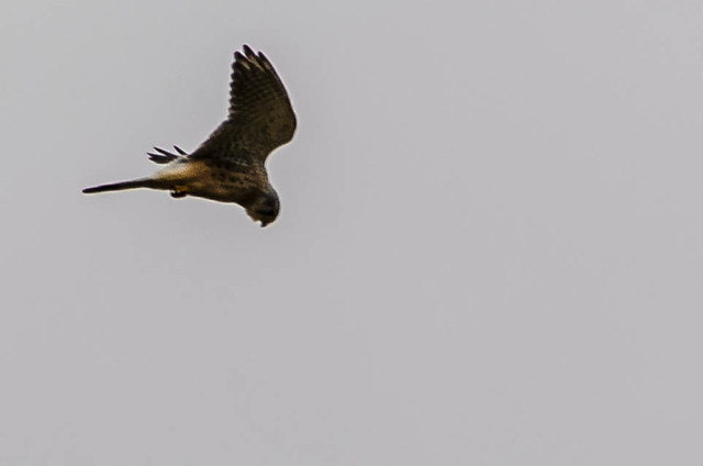

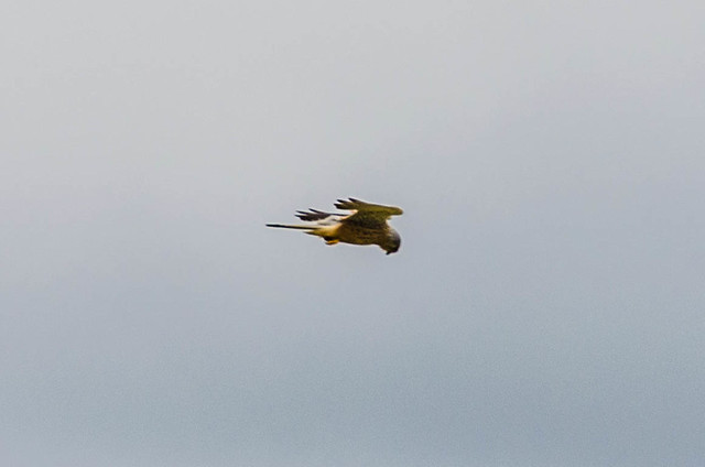

The images I'm taking are very soft with a light halo around the image. I accept most of these are my errors i.e. to slow shutter, badly focused (manual) or wrong exposure but I was wondering if these lenses are good enough. Pictures I'm trying to get are birds on the wing like buzzards, kites and hawks.

Peter, the main issue here is you are far too far away from your subjects. Unfortunately, no equipment change is going to give you high quality over these kind of distances.
The good news is you appear to have found locations where some impressive birds like to frequent, so the trick now is to observe, see if they use regular patterns in flight, and find a way of getting closer.
Try doing some research on local areas and try to make some useful contacts with other locals who are often a good source of knowledge.
In the meantime, try photographing less difficult subjects - waterfowl and woodland birds etc to practice your photography skills on so you are better prepared for when you get the opportunity with the kestrals and their like

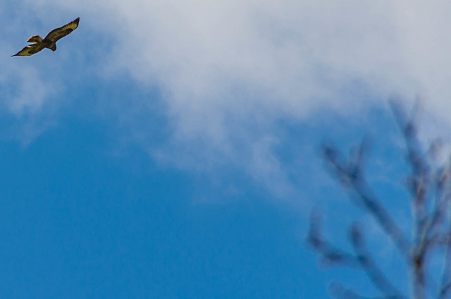

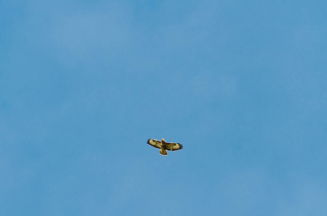

The Hawk was probably shot at 20-30m
The Buzzard at about 120m and the one with a bit of tree about 50m.
Without being able to fly I can't get closer when they are like this.

I would say your lens is fine, I've seen plenty good images come out of a 150-500. I would say you need to get closer, and work out your metering and what's best for you. For many (including me) this is manual so I don't have to ride the exposure comp. I recommend listening to this podcast which goes over manual metering and I found it quite useful. http://www.martinbaileyphotography.com/2013/10/21/metering-in-manual-exposure-mode-podcast-392/ That said I do use aperture priority a lot too. Just not when the background is changing a lot or when the light level is reasonably stable.
You should be good to about ISO 1600 with the 5100 which is the same sensor as my D7000 but it falls apart pretty fast after that, hence my recent purchase of a D700.
Some pretty nasty artefacts from too much jpeg compression or oversharpening, or both. Check your camera is saving the largest, best quality image it can.
I'm surprised they came out this well, the birds were massively underexposed. They are super enhanced, super sharpened and extreme cropped. I actually think the jpeg might of improved them they were that bad :)
