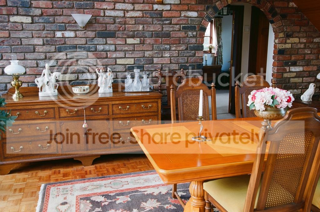

The first photo is from the 6D and shows the full frame photo downloaded from the camera:

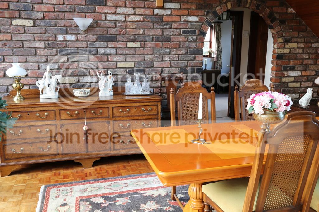

The second photo is from the EOS 3, once again featuring the full size scan received from the lab:

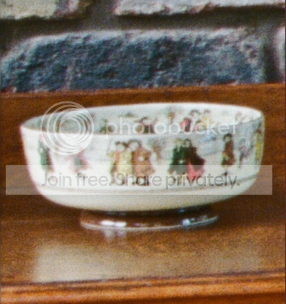

And now the EOS 3:

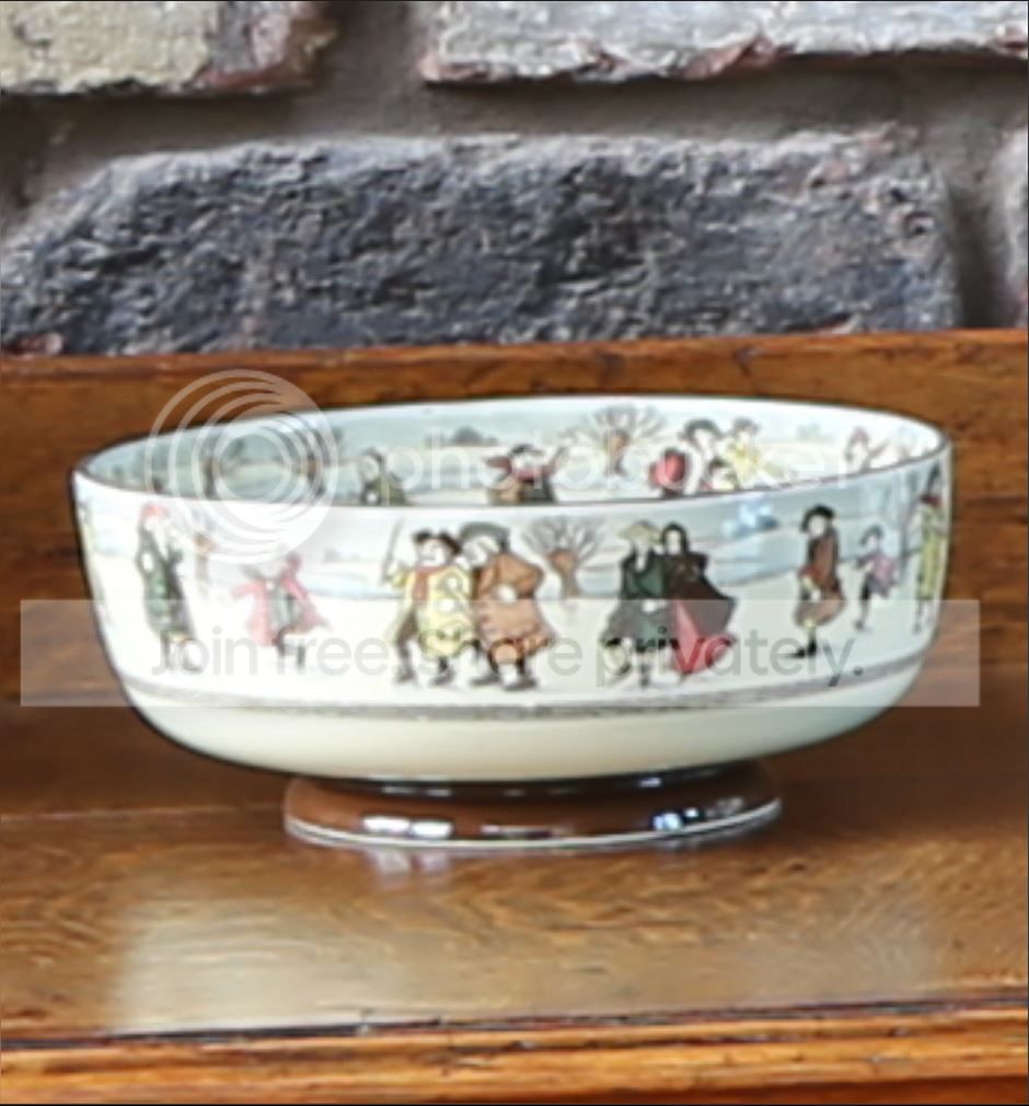

Hmmm, without the 'noise' there might be a bit more detail from the EOS 3 than the 6D? Nice colours too! Let’s try another one:

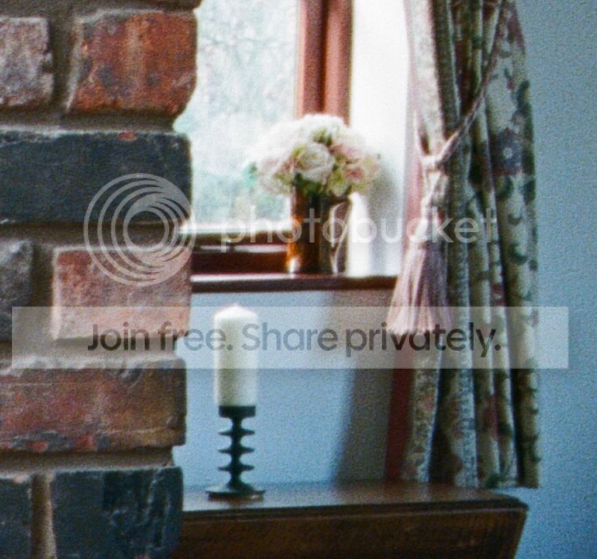

6D
EOS3
A win for the 6D for detail here… it looks like it's going to have to be 'best of three' to decide?

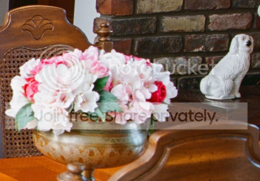

6D
EOS 3
The 6D clearly takes the detail crown in this last one.

And now the EOS 3:
6D
EOS3
6D
EOS 3
