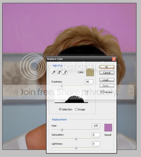

Ok to do this I selected only the top section to avoid the colour replace affecting the rest of the image
Image - Adjustments - Replace Colour
Using the dropper selected the colour on the top area
Adjust the Hue so you can see a significant change as a preview
Adjust the Fuzziness which works like the magic wand tolerance.. this will let you find a level that allows the background to change without affecting the hair too much and hopefully find a level that keeps the two blended.
Once you find that you can adjust the hue, saturation etc to find the colour you prefer.
Hope this helps

Sorry but i'm just not getting this at all, i've tried what you have said but the whole picture is changing colour :thinking: :bonk: is there somewhere that goes through this step by step
The adjustments will affect any colours which are similar to the background unless you create a marquee round only the parts you would like to change.. It wouldn't have to be too accurate.
In the image I posted I notice the 3rd dropped is shown selected.. but you would add choose the colour to replace using the first dropper.. (the second dropper adds more than one colour to replace and the 3rd removes them).
