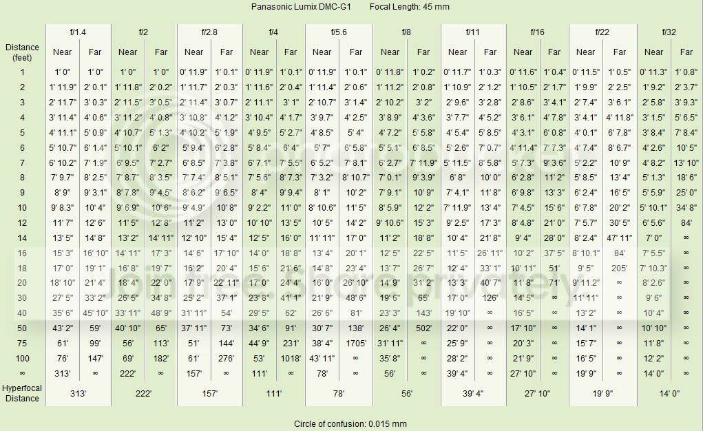

@shapeshifter - It may be a DOF table, but you can still use it to help get an OOF background at small apertures. Hint, distance to subject and the focussing distance to not have to be the same.. I'll let you figure out the rest.
DoF is merely the area where focus is thought to be sharp enough not where focus is sharp, that's limited to the plane of focus. Putting the main subject anywhere near the close or distant boundaries of the DoF will end up with them being soft when compared to them being on the plane of focus. Possibly OK for facebook and maybe just about ok for 6x4 prints but not a lot else.

Am I missing something here this looks like a depth of field chart to me.I thought the OP,s question was about exposure?
Yes, you're missing something.
The OP wanted to throw the background out of the DoF and I suggested ways of doing this and the table follows on from that.
As per your other posts the fact that you missed this comes as no surprise :D
