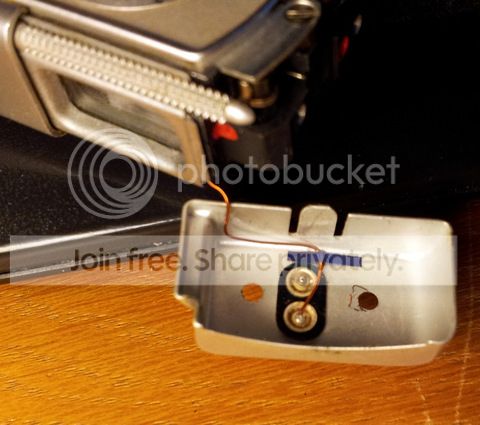

I managed to get those screws our and this is what I found:
I can only see one piece of wire. Where's the lead going to the top terminal? Is yours like that?
Weirdly, yes mine is the same which suggests that the flash connector won't actually do anything!
