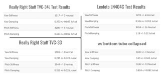

I just bought a Leofoto LN-404C and should get it next week. When I get it I will compare it to my RRS TVC-33 for build quality and stiffness, particularly at typical use height.
I actually got an open box from LeoPhotoUSA at a great deal (+center column + leveling ball/clamp)... yeah, didn't really *need* another tripod, but this thread has got me missing the Gitzo 3542xls I used to have.
