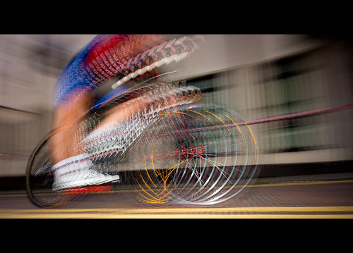

Hi All,
I've been using the strobe flash function on my 580exII with good success (see below) and am now organizing another strobe shoot where this time my exposure will have to be longer, say 0.5 - 1 second, and I think about 8-10 flashes will be required in that time. That would require a setting of 10-20 hz on the flash, and according to the manual, that means my power will be limited to 1-16 or 1/32th.
However, I will need more power than that as I'll be shooting through a brolly, and at more of a distance from the subject this time. I guess the only way to get more power is to add more flashes, or do you think an external battery pack for the 580exII would help the amount of power, or is the algorithm printed in the manual programmed in to the flash and unchangeable?
If then I add more flashes to get more power , I think I would have to use wireless IR to get them to talk together (I have access to a number of 580's and 430's).
Is this the best way as IR is often less reliable outdoors, or is there a better way using Ettl cable to ensure they all talk? I have a 3m Ettl cable, and wondered if it could be modifed, or what else I'd need?
Any thoughts, or anyone else extensivley played with the strobe function like this?
