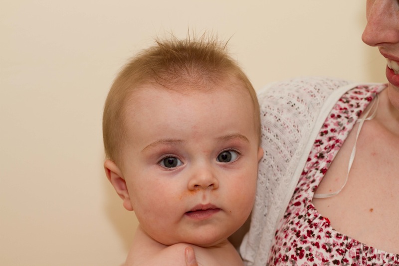

The stofen is on top of my 430 ex II and it is pointed directly up. This is exactly how I would use my flash before the stofen, the angle is identical and I always use the flash on manual. I never get any red eye without the stofen but almost always get it with, like this:

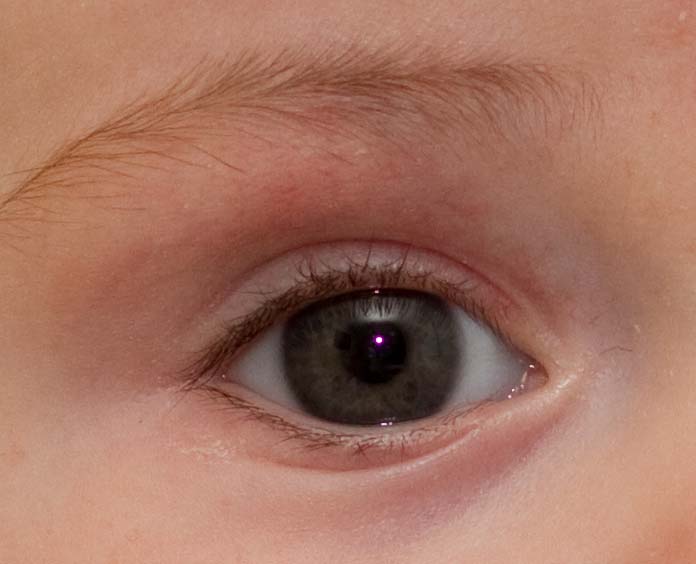

you can't see it great there so here is a crop on the right eye

Joe,
That's not redeye. Redeye is when the whole pupil lights up red. What you have there is some fringing at the high contrast boundary between the catchlight and the dark pupil.
This is redeye....
p.s. I see you shot that at 85mm. I assume that is the 85/1.8. Purple fringing is a common complaint with that lens, although usually only a problem, sometimes, when wide open. Here's an example of fringing with my 85/1.8 at f/2 (100% crop). I did not use flash but the fringing is very obvious. It's probably a combination of PF from the lens and sensor blooming from a localised overexposure of the sensor....
Agree with Tim. That's just a normal specular reflection of the Stofen.

Ok, thanks, it was with the 85mm 1.8 but I also get that effect with other lenses. It makes sense what you are all saying but how come I am the only one who experiences this effect?

Just guessing here, about the colour fringing on the catch lights.
They are reflections, therefore they would be sharp focused at double the shooting distance. In other words, they are well out of focus and out of focus highlights often exhibit a bit of the lens' natural CA colour fringing.
Maybe? :thinking:
Do the eyes look out of focus to
you? They look very much in focus to me
Not the eyes Joe, the reflection is out of focus. Like the image in a mirror. Eg, if you photograph yourself in a mirror 1m away, the sharp focusing distance is 2m.
Therefore, the image of the catchlights is almost certainly out of focus here.
You lost me there. Do you mean inside the eye is a reflection of something and that is out of focus. How do you keep the eye and the reflection in focus? And why does that only happen when I have the stofen on?
The bright spot you are seeing is a reflection of the Stofen off the surface of the eye. To get that sharp, you would need to focus on double the distance. The eye (cornea) is reflecting like a mirror.
In that respect, being out of focus, it is no different to an out of focus highlight behind the subject, twice the distance away, and it is not uncommon for those to show up with a bit of colour fringing. That's what I'm getting/guessing at.
