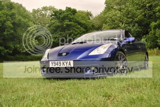

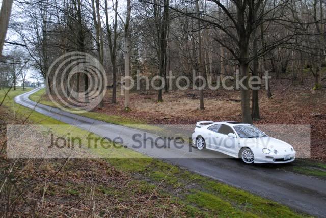

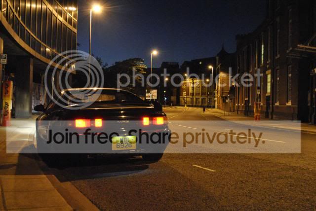

Hi there I'm hoping that someone could be able to help me if possible
I've been into photography for a few years now but never really understood it all. Anyways I bought a D3000 and having just looked on the Ken Rockwell site it appears that the camera's not too good at all.
I understand it's a camera with a crop sensor which I understand means it only captures part of an image compared to a full frame?
Anyways I've been trying to take pictures of mine and friends cars with varying amounts of success as the pictures will show (these are my best shots I think but compared to others on here they're awful)
The 3rd pic was only a quick snapshot wasn't majorly thought out but came out better than some of my others
I'm looking into getting another camera lens but I don't really know what I'm looking for so any help would be appreciated. I'm on a reasonably tight budget so I've been looking into the Nikon 35mm 1.8 lens so if anyone has used it I'd be happy to hear?
My pics seem to be coming out quite flat and I'm wondering if a faster lens would help at all?

Firstly, Ken Rockwell is a wa..... You gear is capable of producing great pictures.
You do need to learn a little about the technical side of photography, but what you need to also understand, is that you take photos of what you point the camera at*.
It sounds so obvious, but think about it, what's the first phot of? A car and some bushes. What did you want a photograph of? A car.
So the 1st issue is to set up the shot somewhere that looks genuinely good, then you need to consider the lighting and reflections. Because ugly shaped light patterns will spoil your car photos.
I'd suggest light painting if you're on a budget.
Just noticed the question at the end, your photos are flat because they're shot in flat light, you can do a little in pp to boost contrast etc, but you need to learn to 'see' the light, light direction and quality directly creates shadow quality, shadows create form.
*classic beginner mistake, we have tunnel vision, and point the camera at a 'subject' rather than looking at the whole frame to see what we're capturing.
Another lens wont really help in this case and you will just be even more frustrated. firstly there is nothing wrong with the camera the D3000 is more than capable of producing much better shots than you are seeing here, same with the kit lens i.e. not stellar quality but more than capable.
What you need to learn is how to expose your shots properly (How to use the light) this is the most important thing of all. Its generally the reason for a "Flat" shot.
Then learn all about your lens and the different effect of focal length and depth of field on any particular shot.
Watch your backgrounds.
A good understanding of DoF and where in the shot to set your focus point will transform your shots.
Get familiar with your camera controls and the relationship between what you set your lens at (Aperture Value) and its corresponding shutter speed (Time Value).
Have a look at other peoples shots and study the composition of there work. Question it, "That shot looks brilliant" - WHY? What stands out ? How is the subject lit ? etc etc.
Use your Tripod where possible.
No one can answer you fully in a short post and others will come on and add even more insight, you just have to take on board as much as you can and have patience and above all, fun. Dont get down, we were all c**p at one time or another and some days I look at my shots and realise I still can be. :bang:
Okay and while I was typing this Phil has come in and given you good advice too. See! you're ahead already.

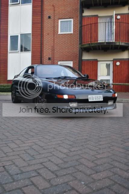

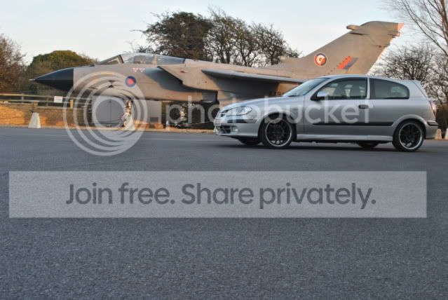

Grabbed this pic today, I tried getting into the more scary world of manual modes etc then I realised I'd had the settings sent to Vivid which was sending the camera into fits :(
After a few tweaks on the camera itself I've come up with this
I realised I've missed the rule of thirds completely so that's something else to work on
C and C always welcomed :)

The biggest problem with this shot is the car is green rather than black, because the brighter light bouncing off the grass has a massive green reflection
Options?
Shoot the shadow side of the car but be aware it might 'flatten' again.
Use a black or white panel as a 'reflector'
Shoot from slightly higher to minimise the effect.
Shoot on a black/ neutral surface rather than grass.
So to add to the remarks about the improved shot.
The lighting is much punchier than the originals, and the background cleaner - so that 's a massive improvement.
What is it lacking?
What did you want it to say about the car?
A car parked in a field with bushes in the background says;
family
caravanning
off road
I'm presuming that your lowered, black coupé was actually begging for:
moody
aggressive
sexy
I know it's a cliché, but an industrial setting or rock / cliffs would suit the car much better.
I may have said this earlier, but the photograph starts with the concept, most people think it starts when they lift the camera to their eye.
