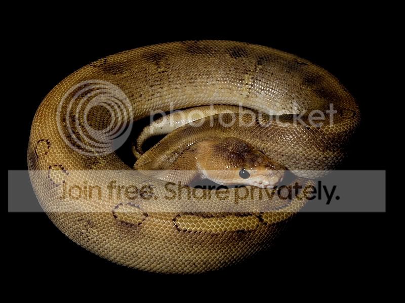

:D Thats the question..been toying with getting the lumiquest snoot..anyone here use one?..I just think for the type of shooting I do it would be great for isolating flash more...this is the type of shot I take 90% of the time

Do you think it would be beneficial for the type of shot above?
A snoot will control your light spill and if you mount a stack of straws in the end of the snoot it will feather the edge of the light more than just a snoot - the longer the straw, the more the feather.

Do you think it would work well on type of shot I will be taking?
You can try it for next to nothing with a cereal box and straws for a quick and dirty shoot - If you don't like it you've lost very little apart from eating a weeks worth of weetabix in 2 days and on the plus side you'll be very regular for a while :eek:
