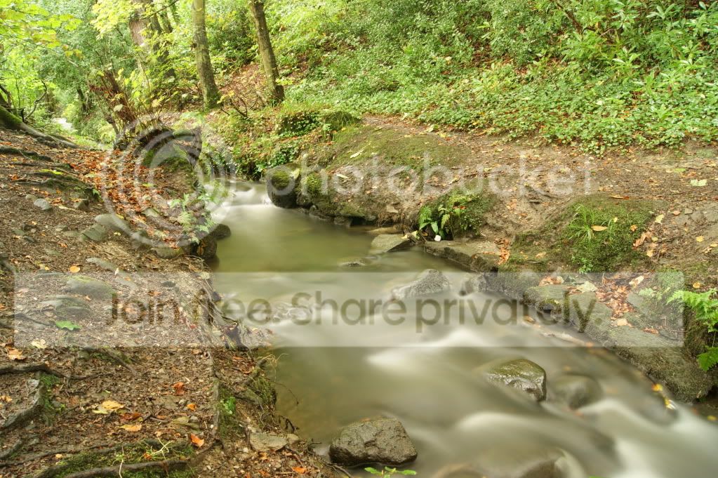

i got this shot in a very gloomy part of the local park, i was actually surprised at how bright it came out.
f/14 20sec iso 100
if you can find a similarly gloomy area with a stream set your tripod up and try your hand at it. this was my first attempt at long exposure shots so if i can do it anyone can lol

Thats great for a first try
That's a great shot, I haven't even began experiment with slow shutter speeds yet.
