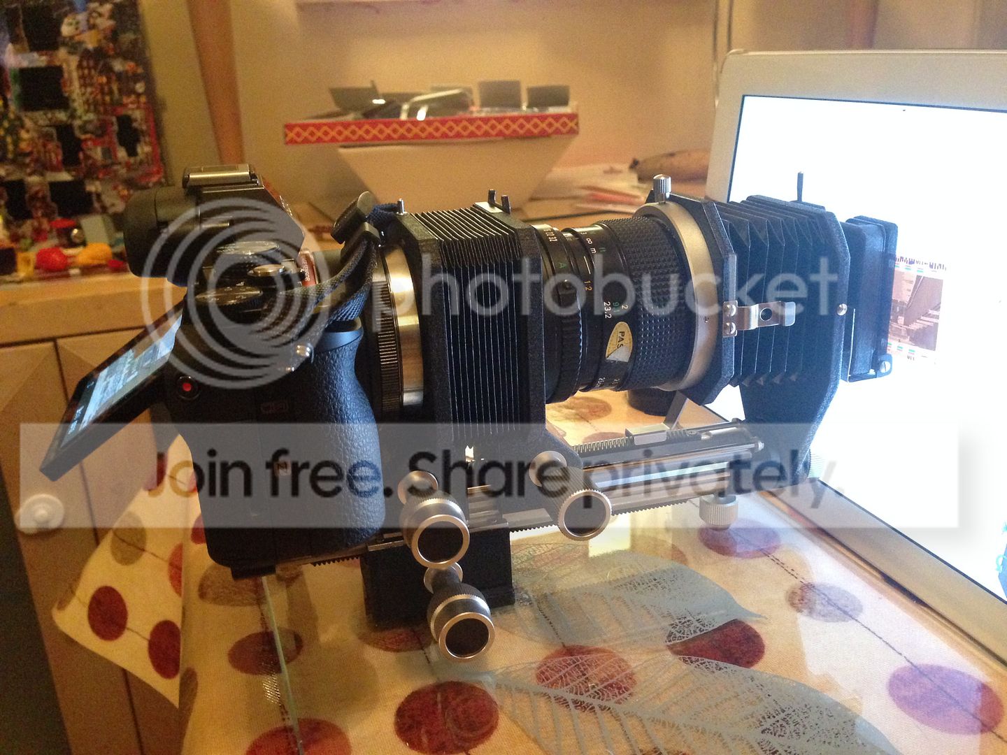

It's a few years* since posted my setup using an FD autobellows and an FDn 50mm f/3.5 Macro for the same purpose - I've a photo of my setup if it will help.
Now, with my full frame Sonys (the A7 has been replaced with an A7II since), it's a little tight, but there is still some room for manoeuvre at either end and I don't have any problems achieving 1:1 reproduction.
With a 5D it's possible you might be running into problems because register distance of FD is slightly shorter than that for EF, though.
I'm assuming your FD to EF adapter doesn't contain any optical elements, which they would have to have to achieve infinity focus for regular lenses. I never bothered trying to use any of my extensive collection of FD lenses with my 5D Classic because it the register distance made it a PITA.
