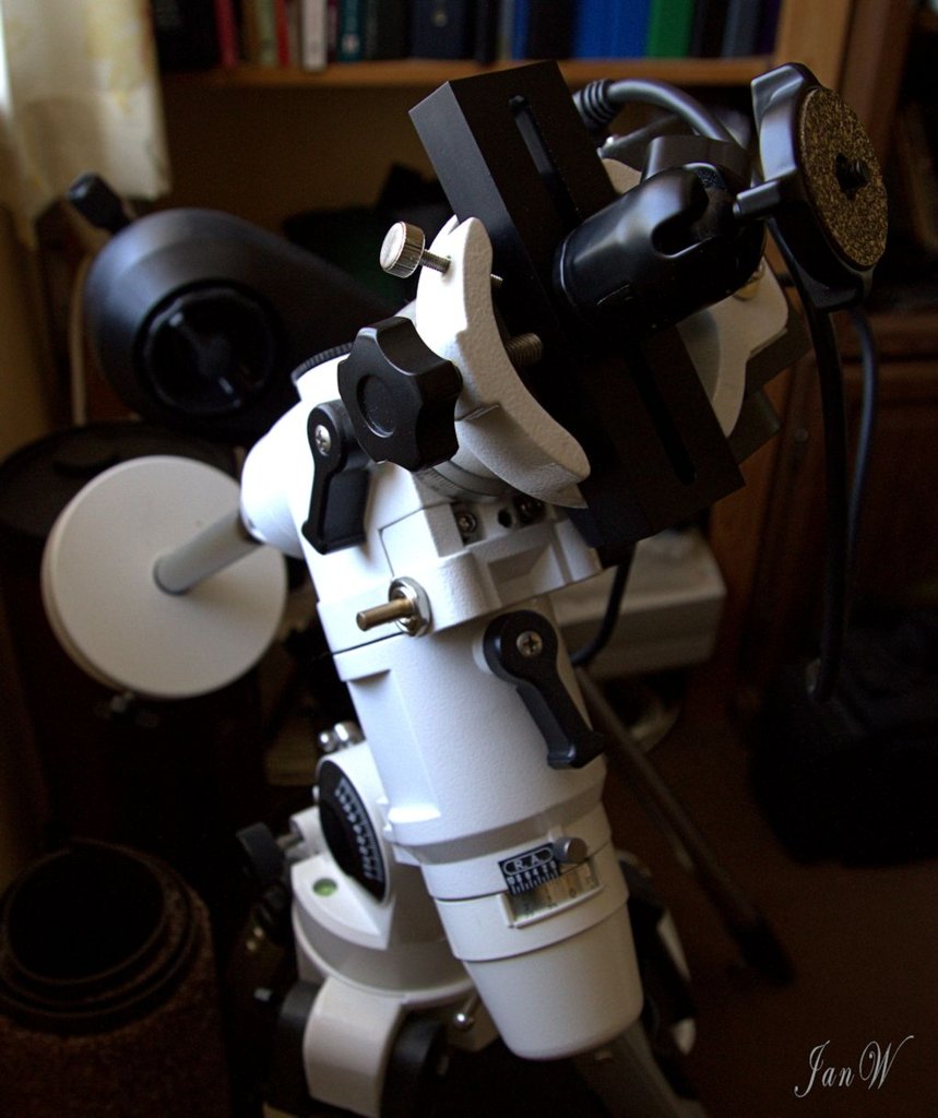

That looks like a heftier version of the mount I use for astrophography with my Sigma 150-600. All you need is a wedge with a tripod screw. Then you can either add a ball head or mount direct to the camera/lens bush. Got to be out this morning but if you're interested I'll see if I can find where I bought my wedge and post a pic. Is the one you've found the GoTo version? If you intend just doing wide field (Milky Way type) shots it doesn't matter if it's not, but if you intend using a long lens as I do, it'd be a world of frustration without it.

White shroud? Just looks to me like he's got it part dismantled. This is my head with ball head on wedge, though usually I'm using a long lens so the lens foot bush is direct to the wedge. 'Scuse rubbish photos - to move the mount out of its place I've got to move loads of other stuff first. House it not big enough! I'm not sure why you'd need to remove something to attach a camera, but I do like to keep things simple.
