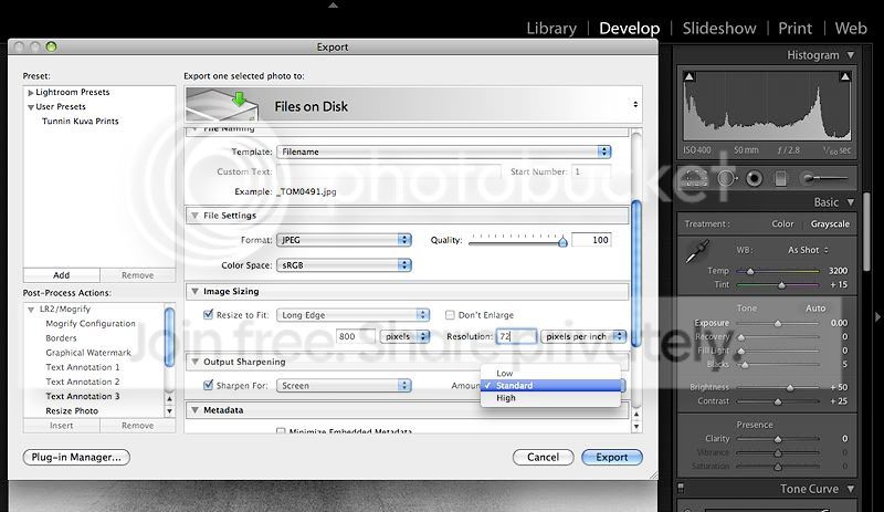

Just export from Lightroom at the sizes you need and set the sharpening for the output type - screen for screen/web/etc. or gloss/matte for prints. LR sharpening is the last stage so it will be fine. The only time you might want to turn it off is when you plan to do further edits outside of LR.
Basically,
EXPORT>
See below
The hit OK. Job done. :thumbs:
