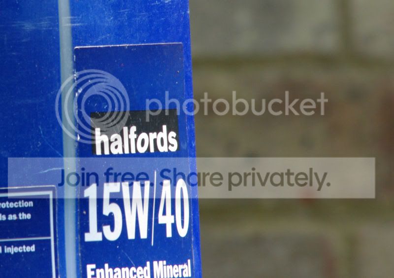

Taken with my Pentax and 150=500 and 1.4x -
Not as bad as I expected, the setup is of little practical use. AF very slow if it worked at all, viewfinder very dark.
