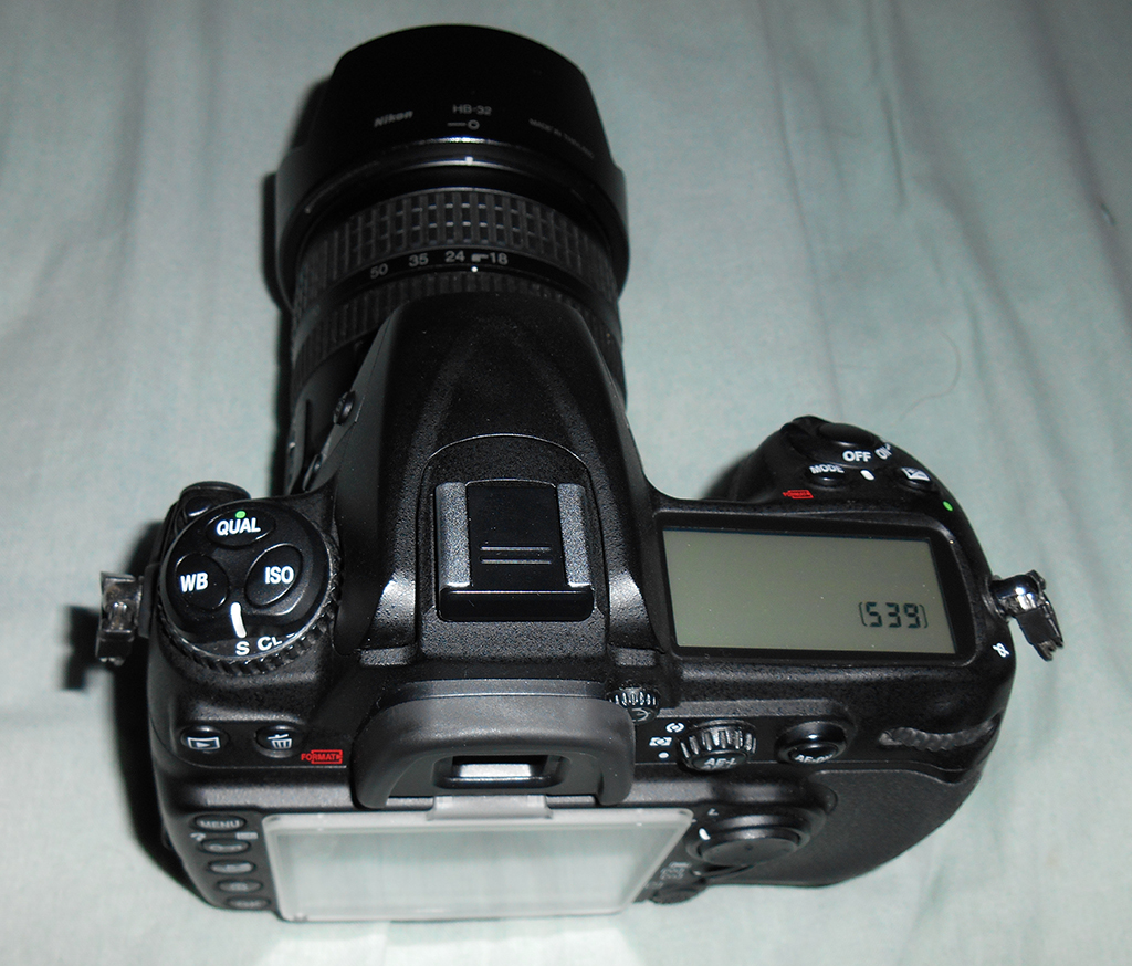

Hi guys,
This is it here:
When I received it, it was in "M" mode, not sure about if it was the camera shop putting it to this or what.
But for 290,000+ shots and none of the buttons, words or grip has weared away? I'm not sure.
If it looked beaten then yes I would believe it, but to look mint and have this much???
