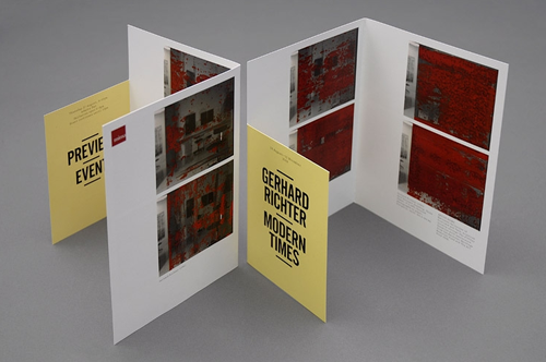

I'm in the process of building a new setup to photograph my work, currently using a 400D but just about to upgrade to a 5DMkii.
Could anyone recommend a good lighting setup for this kind of photography (see image below as an example of what I wish to achieve). I'm currently looking at some Smoke Grey Camulet background paper but am struggling with the lighting (strobe/constant and also lighting positioning) as I don't normally handle product photography.

This is a very easy subject, the lighting doesn't need to be creative and all that's needed is two light sources and large diffusers (to create soft but not totally flat lighting).
You might also want a wall boom, this one from Photomart is probably ideal. This will allow you to place a softbox overhead and to angle it exactly as required. Then you need a good quality but reasonably priced 2 head kit like the Lencarta SmartFlash and although you won't need the umbrellas included in the kit, it's actually cheaper to buy the kit for just £250 than you buy the items individually, and 2 large softboxes like these.
You might also consider a grey vinyl background instead of paper. Cheaper in the long run, wipes clean after use and can produce a subtle reflection, which adds to the interest.
