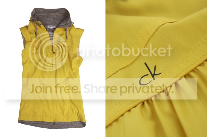

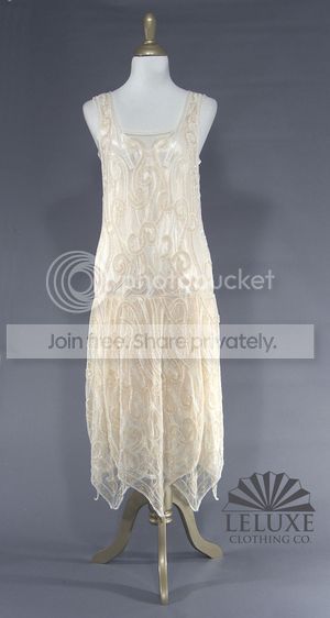

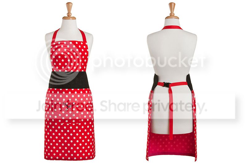

IMO, the different types of lighting serve different purposes and accomplish different thing.
One is obviously simplicity/speed.
But if we apply it to the different product shots supplied here:
In the first image, the flatter lighting could be considered beneficial. It's helping minimize the wrinkles etc.
In the second image the flatter lighting is still acceptable IMO. the product is more about color/pattern than details...however, the flatter lighting is de-emphasizing the pattern in the black fabric.
In the third image the flatter lighting would be considered detrimental (IMO). This piece is very much about the textures/embroidery/lace etc...the side/rim/back lighting that Gary described would be much more beneficial in bringing out these details.
I guess the lighting could be equated to the product... The more expensive the items due to "greater attention to detail" makes lighting to emphasize the details more important.
