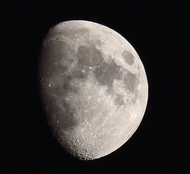

this moon was shot at
Camera Canon EOS 600D
Exposure 025 sec (1/40)
Aperture f/18.0
Focal Length 400 mm
ISO Speed 200
Have a play with the settings and take loads of shots as the quality of shot can change even with the same settings
Aperture f/18.0
Focal Length 400 mm
ISO Speed 200
Why f18? You're using an aperture that will make the image softer due to diffraction as well as forcing a very slow shutter speed, which can only impair image sharpness. If you'd have used f8 then you'd have been able to use something like 1/250s
Even with a tripod, a faster shutter speed will help prevent vibration induced blur.
On the night when I was taking shots at different settings this was the best of the bunch, if I had one at f8 as sharp I would have shown that
f8 should have been noticeably sharper, as the lens would be suffering from less diffraction effects, and you would have had a faster shutter speed. Seems to me this was just chance it was the sharpest. I'm assuming you were using a tripod, so perhaps the actual releasing of the shutter is adding some vibration. Remote release used?
Yes I used a tripod and a shutter release , I have had sharper photos at f8 with the same set up but not of the moon, it was the best of the bunch that I took that night
