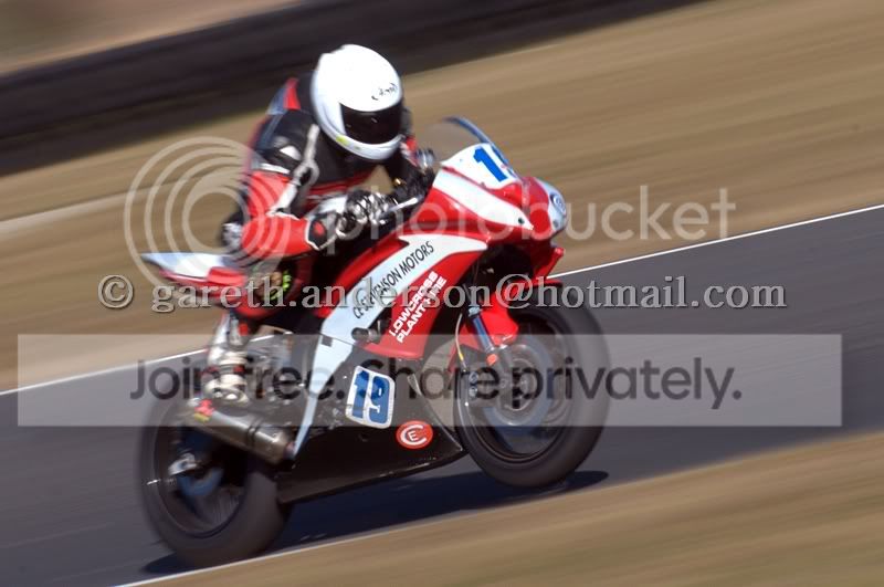

Now that the bike racing season has started again I seem to be sent a lot of 'safe' shooting? Crisp images but static wheels. Maybe it's just me, but I was trying new things for this year and even shutters down to 1/30th but the acredited 'tog are all playing it safe. Is it because they are 'getting their eye in' or just that the general public aren't too fussed? I've been told some images were blurry/OOF but what do you expect at 1/50th LOL

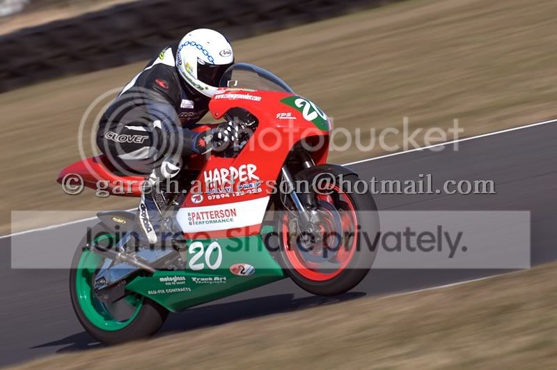

Maybe I'm just wrong. Here was the best slow shutter I got at the weekend,
Bit too slow IMO...I think you could go a bit faster and still get spoke blur on those machines - I know I have to go below 180th sec to show rotor-blur on helicopters (after it was kindly pointed out to me here that static rotor blades look like models stuck onto a blue background - you'd think I'd know stuff like that after all these years...lol).
I reckon those wheels are spinning higher rpm than rotor blades...

I've got a few keepers from my loop stuff so now I can push harder and try slower speeds to get different shots
1/50 is bloody slow for panning espesh without IS
The "not bored photographer" types want to see a little motion blur on the background but the subject itself nice and clear generally.
Panning shots with silly slow shutter speeds rarely get printed - go check out the monthly publications.
Even the Motorsport section "slow hand" regulars almost certainly won't be using those nuts shots commercially.... you just don't get to see the bread and butter shots ;-)
1/160th is around my usual for wheel blur on bikes on all but the slowest corners at East Fortune or Knockhill.

Is it??
I'd get rid of the watermark for starts.
the images is too blurry use faster shutter speed
I'm not really looking criticism on my own shots. I'd normally shoot from 1/100th to about 1/250th (see below) or at f2.8 for head on shots. What I mean is that a lot of the guys with acreditation are shooting static bikes doing about 100+ mph. When I look at their shots I can't help but think they are failing themselves as a photographer as they aren't really capturing the moment.
slower than I'd go without a bushhawk again I'm talking lowfly but it stands. On my non is 70-200 at a 1/100th my keeper rate is very low (slow hercules's fast jets tend to be a lot quicker). Playing with a very nice mans 100-400 with mode 2 IS 1/100 nailed shots every time
^To me that looks fine. The bike is still clear but the spokes are blurred...
Having never shot low fly I can't comment there, but having shot a lot of motorsport I wouldn't have said 1/50th was excessively low.
Most motorsport photographers haven't really shot that much since Novemember and probably want to blow the cobwebs a bit. Also could have been windy or cold and these can have a bearing on keeper rate at slower shutter speeds, especially if they've forgotton their gloves and have lost the feeling in their arms.
I did a track day the other sunday to get into the swing of things and it felt good to be out there again.
