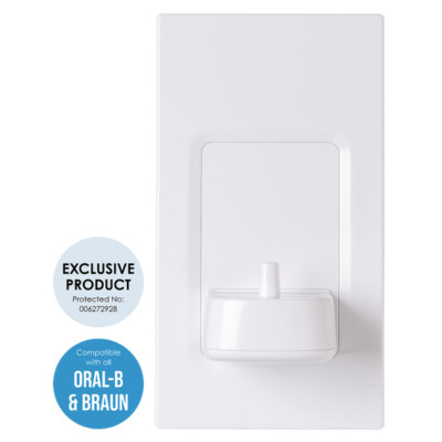

These seem a better idea for charging. Not sure what IP category they’re in though.
Thank you - yes the bathroom designer suggested something similar and when I found them they seemed amazing. Unfortunately the bit where they say "Fits all Oral-B and Braun" is "pure advertising hyperbole"..... They don't fit Oral-B's very popular iQ range at all.
