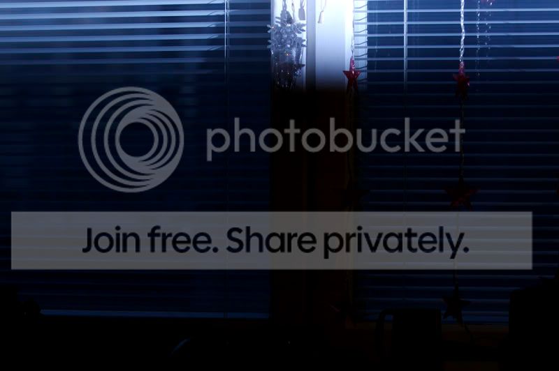

Hello, someone please help!
I have just received a cactus v2 radio trigger today and upon testing it out it appears to be doing something weird to my 30D. Here's a sample pic, its our apartment window with the flash gun aimed straight at it.
I'm getting a huge black shadow across the images I take leaving only a small portion of the photograph visible. At first I though it was the position of the flash but eliminated that thought with moving the flash around a number of times.
When I remove the transmitter and shoot everything is as it should be. I've tried hooking up to the PC/SYNC socket and attached transmitter via the hot shoe and still this happens.
I know these triggers are cheap and unreliable but I've never heard of this happening before. Could it be a faulty transmitter? I havent a clue!

shutter speed 1/500 no chance!
slow it down max is prob around 1/200 or 1/250
what's happening is the flash is firing before the curtain is fully open
and at higher speeds the 2nd curtain departs before the first has arrived so you get a travelling slit!

Mike your a champion and I am a muppet. Works fine now. I was so excited to try it out I think I just went a bit peculiar. Thanks for such a speedy response and taking the time out of your day to help a puddin.

it's a camera thing
the highest shutter speed you can use is the highest speed at which the 2nd curtain moves only after the first has finished
some flash guns claim to get round this by firing pulses or strobes to effectively lengthen the flash duration
never been convinced - yet
