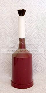

Like most people with a dsrl, I have suffered with dust on the sensor, and we all know how difficult it is to clean. So I was giving this some thought, of an easy method of doing it. I came up with the idea of using a very old blower brush and a vacuum cleaner. We all have these. I trimmed the brush down to about 10mm, this left the brush much stiffer but still very soft. I then attached the brush to a vacuum cleaner via an attachment that came with the cleaner. see pic. 2mins of using this left my sensor spotless, better than anything I had used in the past. Instead of just moving the dust around in the camera, it sucks it all out. Just thought I would share.

Most things on the market just tend to move the dust around in the camera.
As I have said 2 mins, and not a dust bunny in sight.
