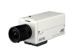

the next in line is the JVC C920E i have a couple of these but only one is used at the moment
these can be picked up used quite cheaply from the likes of ebay and if bought cheaply enough ( around 40 / 50 quid ) are a bargain but you will need an outdoor housing if used outdoors
the beauty of these cameras is that you can use a lens that suite the purpose and there is no tom foolery going on with the so called low light sensitivity ( LUX ) because it is determined by the lens you use ( similar to your DSLR ) i have a F1 lens attached to one of mine which as you can guess is pretty good at night
most CCTV cameras that boast infrared LED's are not that sensitive the figures are made up using the LED's the spec will say 1 LUX but the reality is more like 4 to 8 LUX without the infrared Led's switched on which with no ambient illumination is pretty rubbish
as far as SD CCTV cameras go i like these but they can be a bit bulky when used in a outdoor housing and can be a bit of an eyesore on domestic property compared to smaller cameras or dome cameras
