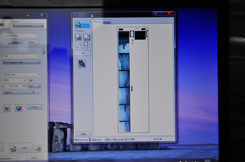

@BY tried that, right here is what im getting on the left is the other roll and on the right is the mystery roll

Also scraping the barrel for an answer ;).....You have it set for 48bit color erm but you should still get something.
Any chance you can take the same picture but put a piece of each roll up against the screen too? (along the white strips)

There are no spaces between the frames even in that picture, but is the black space at the top the film leader?
Flipping the film makes no difference, you just get back to front scans, but there is something very odd going on for it to not show up at all. It looks exactly like the surrounding neg carrier which is entirely opaque, but if there is an image there which can be seen then it obviously isn't opaque :bang:

From the screenshot, I'd try grayscale and not 48bit colour, and I'd try setting to display thumbnails instead of drawing the boxes for scanning. Only as a test at least.
