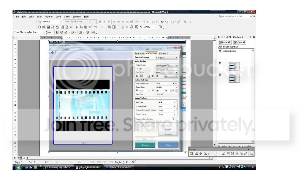

here is my tried out but failed:

Try taking a screen shot of your scan window. Just press 'Print Screen' on your keyboard which copies the screen to memory. You can then open it in any reasonable processing package and post a copy here.
