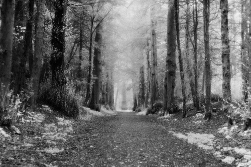

You can get results from overcast or shady conditions.
These were taken in a shady woodlands. Without looking at my notes I think the exposure time was about 30s @f8.
