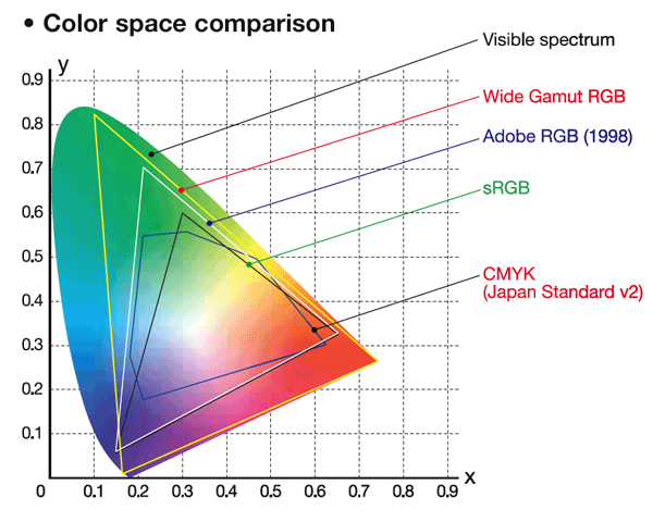

Looking where lilac is on the CYMK vs "monitor" vs Pantone diagram here, and the associated text, could it be that your lilac is out of gamut for CYMK?
(I would guess that their "monitor" gamut is sRGB, but it is only a guess.)
EDIT: this diagram is a bit clearer.

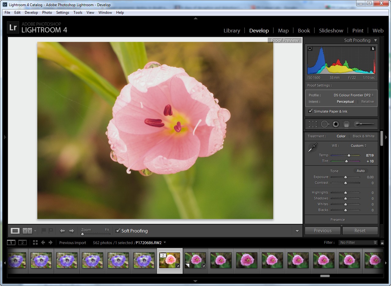

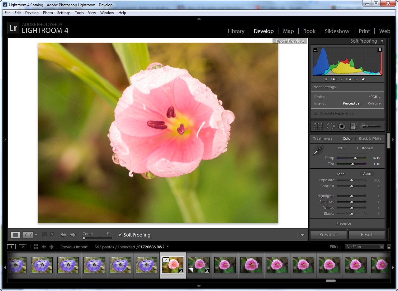

Here is an example. I have turned up the temperature to make the problem areas bigger and easier to see, but the issues are still there at a more "proper" temperature, just not so much so. The (raw) image is unprocessed apart from the temperature change and Lightroom's standard input noise reduction and input sharpening.
This is what the image looks like using the sRGB gamut.
Lightroom 4 soft proofing Perceptual sRGB by gardenersassistant, on Flickr
Here is what it looks like using the profile for the Fuji Frontier printer used by the commercial printer I use (DSCL).
Lightroom 4 soft proofing Perceptual Fuji Frontier Printer by gardenersassistant, on Flickr

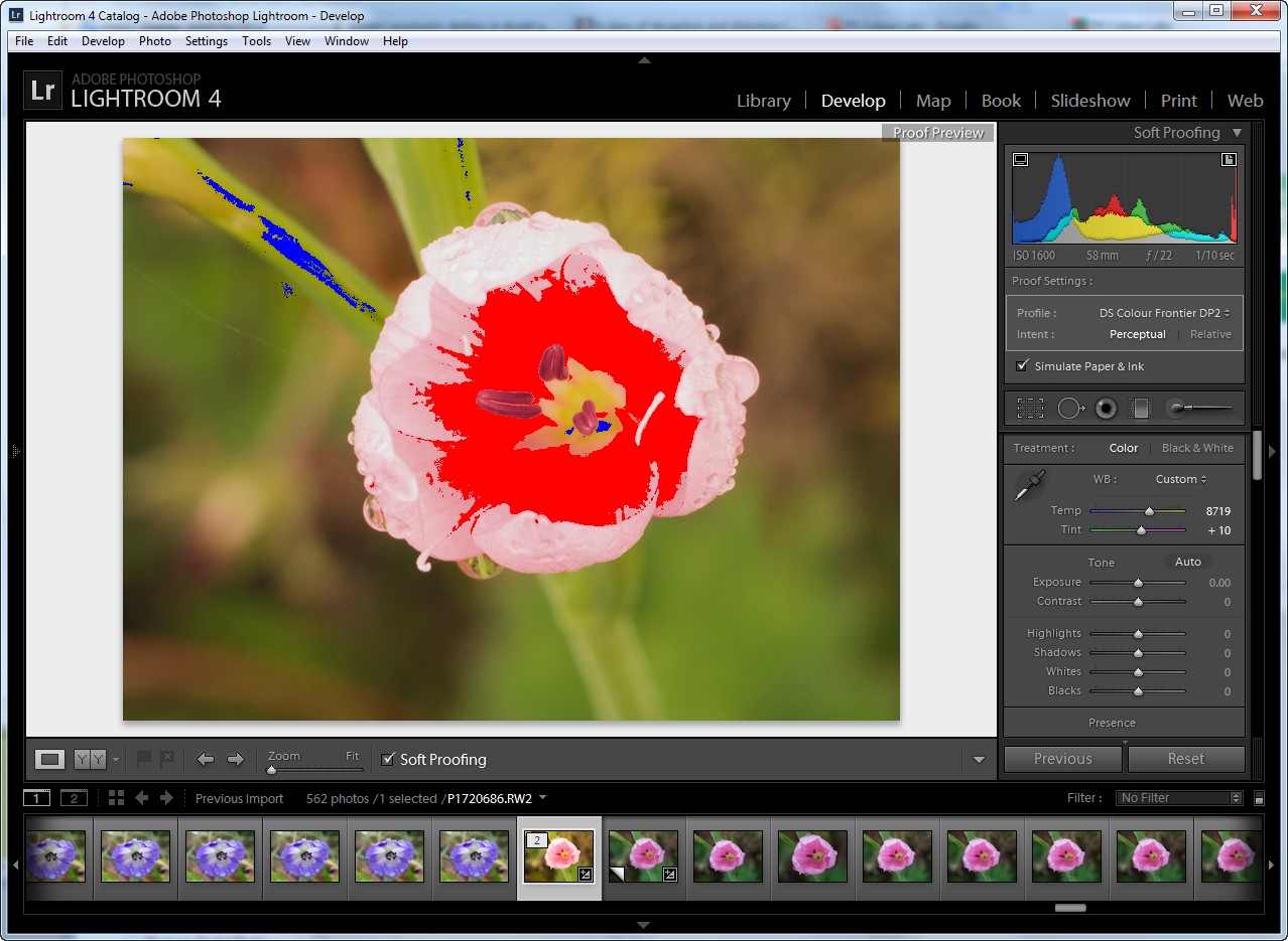

Here is what I got when I turned the gamut warnings on.
Lightroom 4 soft proofing Perceptual gamut warnings by gardenersassistant, on Flickr
The red areas are the Destination (Fuji printer) warnings. These are all to do with pink colours in the image.
The blue areas are the Monitor warnings. These are all to do with green areas.

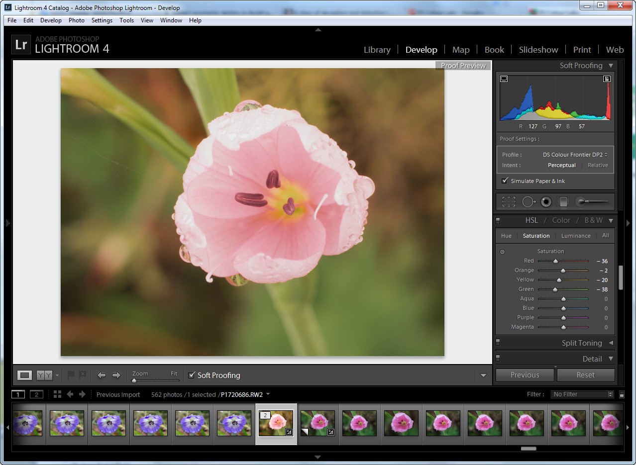

In the next screen capture, on the panel on the right hand side you can see some reductions in saturation I made which brought the image back into both the monitor and printer gamuts. Bringing the Red saturation down brought the image back into the printer gamut. To get the greens back into the monitor gamut I first reduced the Green saturation. I had to turn down the Yellow saturation a bit to finish off the job.
I was interested to see that turning the Red luminance down made the printer gamut problem worse. Turning the Yellow luminance down made the monitor gamut problem worse for the little, yellower green in the centre of the flower. Changing the Green luminance in either direction seemed to make the green gamut problem shift around to different areas, but not obviously better or worse in terms of the amount of it.
Lightroom 4 soft proofing Perceptual saturation adjustments by gardenersassistant, on Flickr
