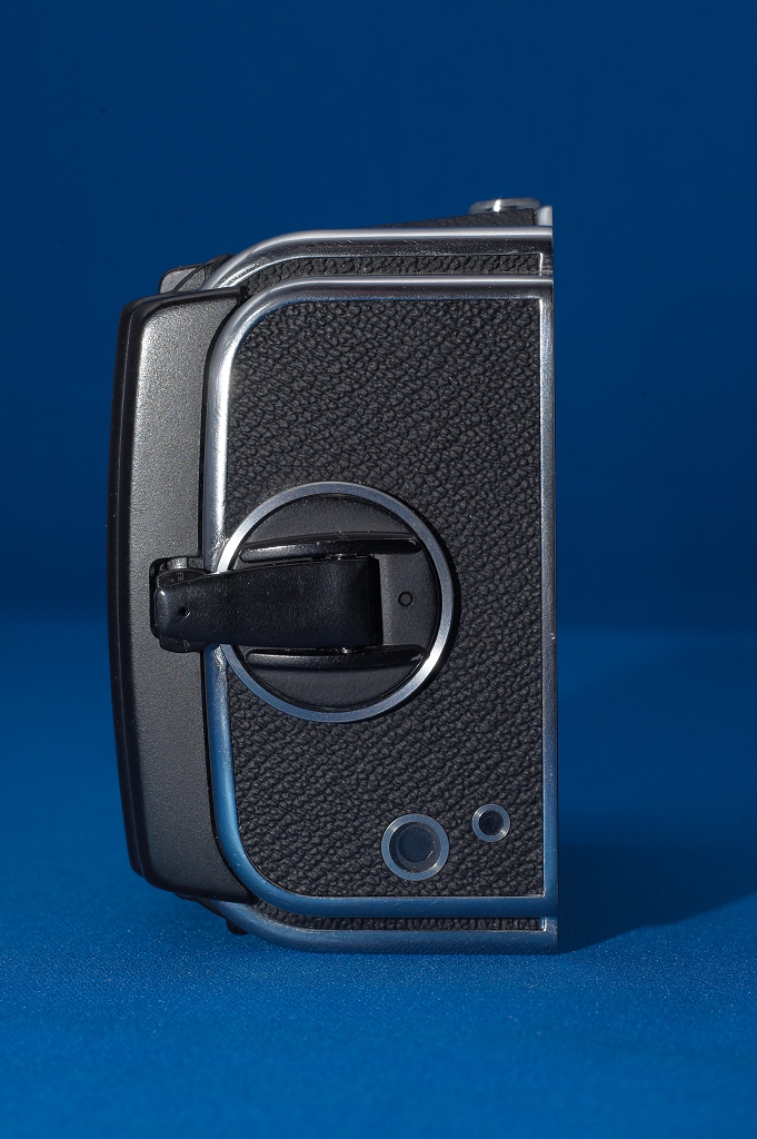

Anyway, a couple of test shots both taken with the back mounted on my 501CM at 50 ISO and with the Planar 80mm f/2.8. The first shot was using a 21mm extension tube.
A12 small by tonky8203, on Flickr
Full size version here...
http://www.flickr.com/photos/tonky8203/6123733952/
Music small by tonky8203, on Flickr
http://www.flickr.com/photos/tonky8203/6123190987/
I have to say I'm very impressed with it. It is obviously a studio tool and it's strengths lie in portrait, product and probably macro work where it's still a very capable tool. despite being outgunned now by much newer backs which you need a mortgage to buy! That's not to say it can't be used out in the field provided you don't mind carting the laptop - in fact I may just do that very shortly and if I do I'll update this post accordingly.
