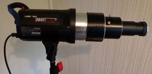

It has the almost universal S-fit mount for Bowens and nearly all other lights. I tried it with my Lencarta SmartFlash, it fits and works, but the old design of E27 modelling lamp is far too long, so it can only work with the modelling lamp removed. That sounds like a major challenge but it isn’t, or at least it isn’t a real problem when using gobos, because we can use trial and error to position and focus it

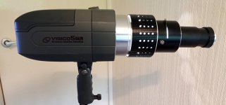

I also have a flash head that's fitted with an LED modelling lamp, which makes things a bit easier

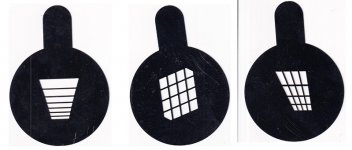

Just a few of these gobos – including some of the least tasteful – are shown here.
As the video shows, the gobos are made from what appears to be stainless steel, they’re shown as black here because I’m too lazy to photograph them, I simply stuck them in my office scanner.
Interestingly, 3 of the gobos are angled rather than square-on, and I think that this shows some thought. One of the challenges of using a gobo to light the background is that it’s usually difficult if not impossible to position the focusing spot square to the background, so we get a distorted effect. The angled gobos, which of course are reversible, allow us to get a straight-on effect from an angle, from left or right, above or below the subject.
