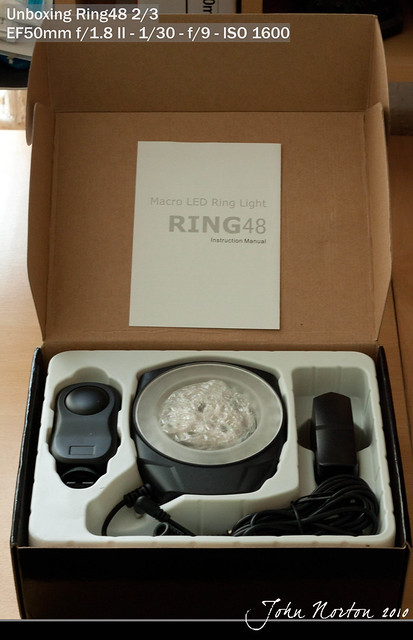

The first thing that surprised me was that it came in a big shiny box (I'm used to things chucked in a jiffy bag!).

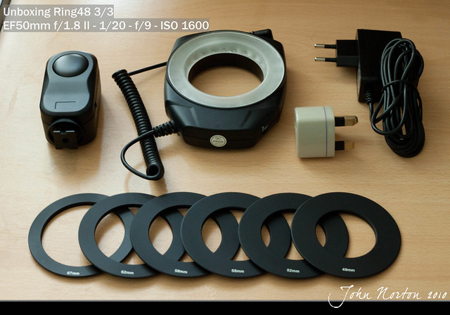

Here are a couple more unboxing shots so you can see what you get.
The box contents are:
The ring itself
Six ring adapters (49, 52, 55, 58, 62 & 67mm) - which is handy as it for my DCR250 as well as my normal lenses
A power supply for mains connection when in the studio/home, but it does run on 2xAA batteries.
Now for a bit of the back of the box fluff:
Effective Distance: 1.1" to 40" (3cm - 100cm)
Power Rate: Semi, Full (I think this means that it can do full ring or left/right sides independently)
Service Time: 1.5 hours
LED: 48
Colour Temp: 5500K +- 6500K

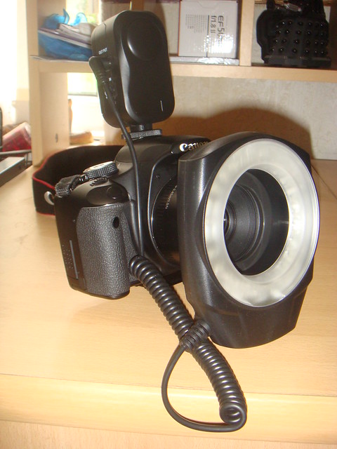

Just one last image before I continue - one of it attached to the camera:

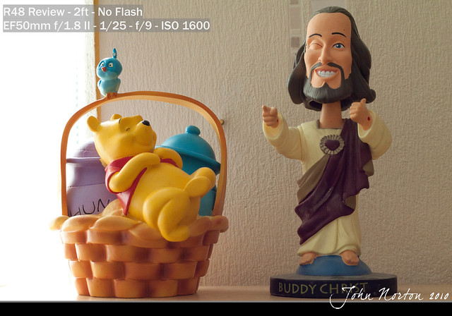

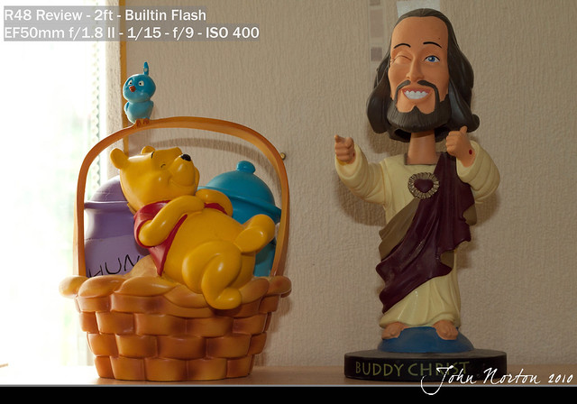

Now these next set of images were taken at 2 feet away (61cm) with an eye to seeing how at even pretty close range the falloff way quite high, but then this is sold as a macro ring so we should not be surprised.
I'll start off with two shots - no flash and built in flash just as a comparison.

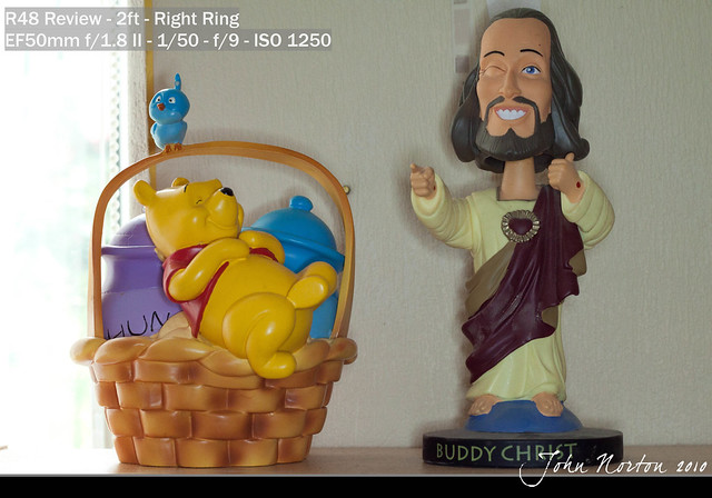

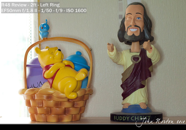

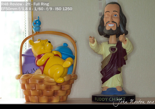

The next images show the different lighting available using the three on ring settings - Full, Left (where only the left hand side LEDs are lit) and right (guess how that works )
Righty on to the more useful stuff.
Well to my untrained eye that's not done a bad job really.

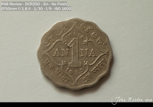

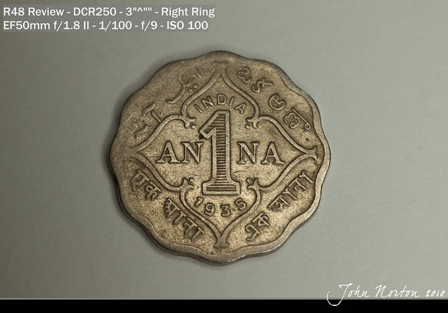

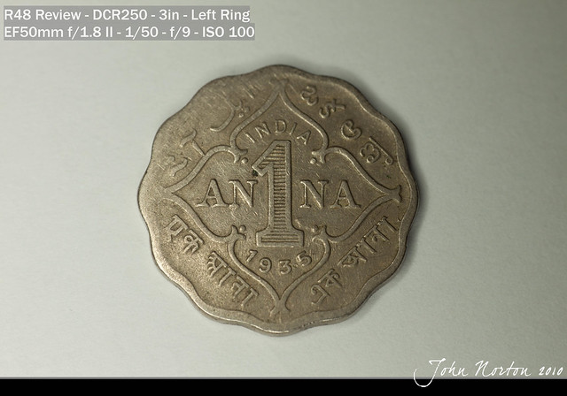

Next on to the real purpose of the ring - macro.

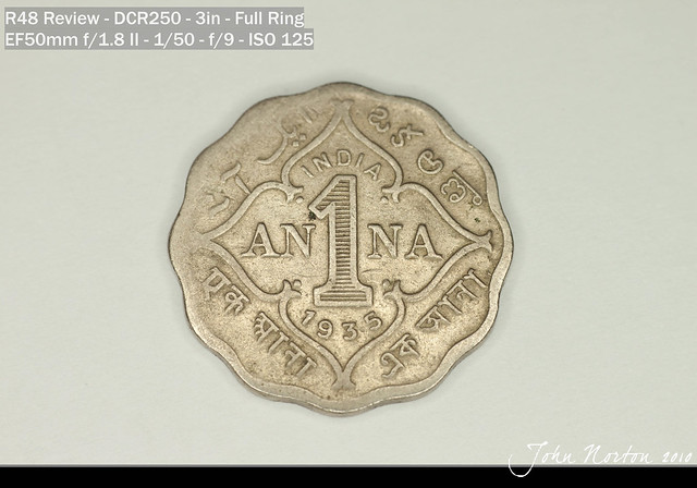

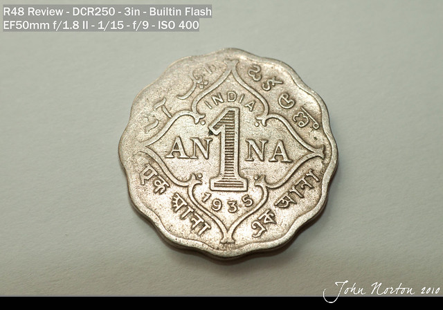

For this I've attached the Raynox DCR-250 (yes another cheapie bit of kit!) and got a wee bit closer - 3 inches (7.5cm) to be exact(ish), ah now as I forgot to add scale the coin measures 2cm across.
Again I'll start with the reference shots - no flash and built in.
Now to the images you probably scrolled through all this waffle to get to
I think the images speak for themselves - not bad
