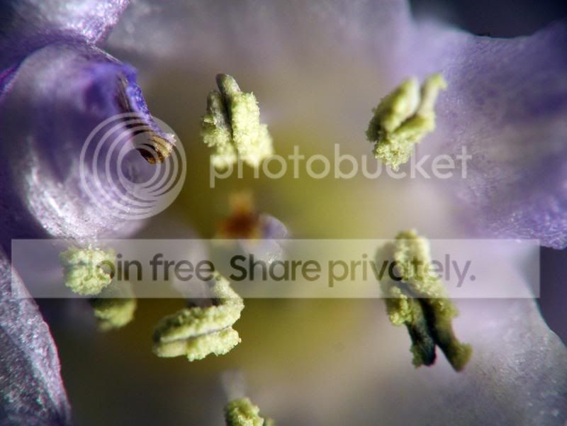

Here's one from my D80 a few years back, this was a 55mm f1.4 Minolta lens reversed using gaffer tape, the nodes on the stamen are under 1mm in diameter, this is not a 100% crop:
wow there what i call macro.lol some top shots there chaps i really am itching to get mine now think i may invest in either a set of bellows or adapter ring.

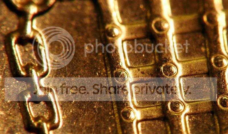

this is the eye of a needle using a £1.50 50mm SLR lens from a boot sale reversed up against my Canon G6 when i had it.
that is impressive.
