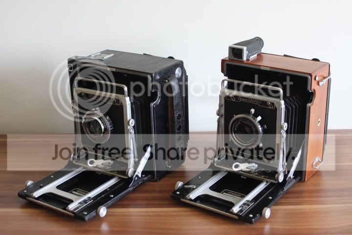

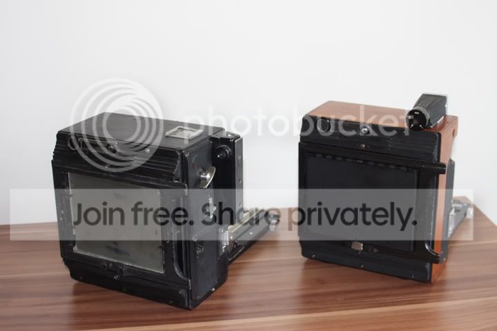

A few of you may remember this thread, where I restored a large format Crown Graphic. I managed to get a Speed Graphic for a very good price that I am now going to restore.

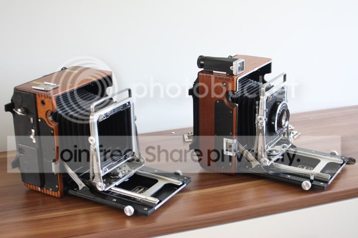

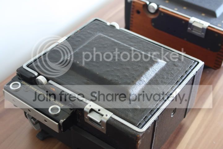

Its in an ok state but the FP shutter isn't working and a few parts are missing so should be fun. Here are a few images to show how it compares to my crown...
The plan is to maybe sell it on, will keep things updated on this thread for those interested.

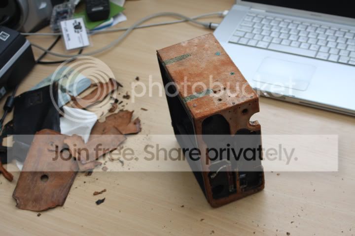

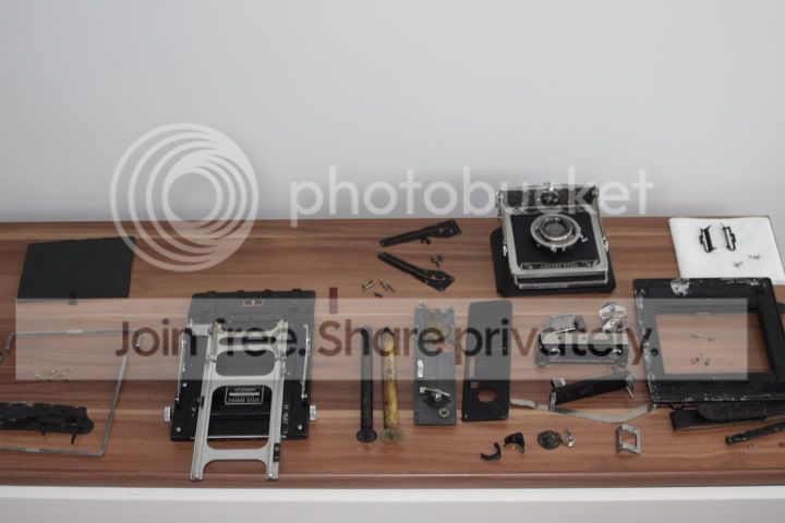

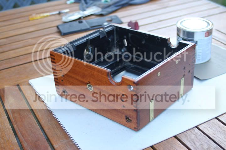

I have now stripped it down and the leather has been removed. The good news is that the wood looks in good shape but the shutter curtain is missing. I will probs just restore it with out the FP shutter as the lens shutter works well and it will probably be very hard to find a replacement curtain...

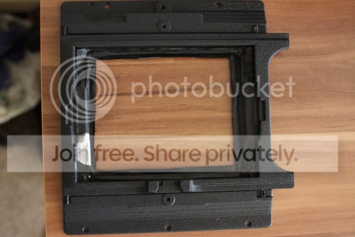

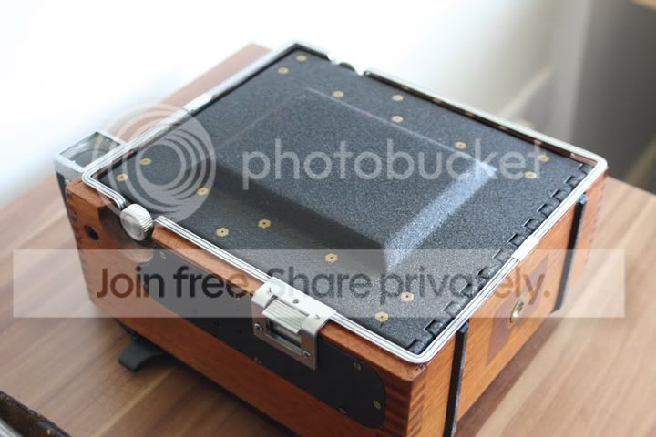

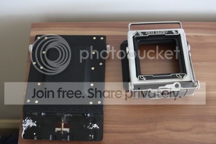

I have been busy recently but so far I have:

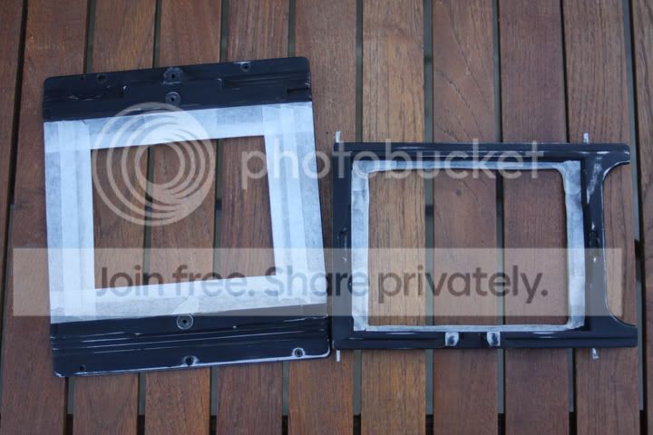

-Made/ground a new ground glass
-Onto the third varnish of the wood

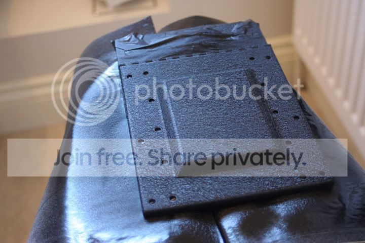

-Front drop bed: sanded and sprayed with wrinkle paint
-Rear standard has been sanded and awaiting spraying, not sure on whether to spray mat black or use the wrinkle paint...

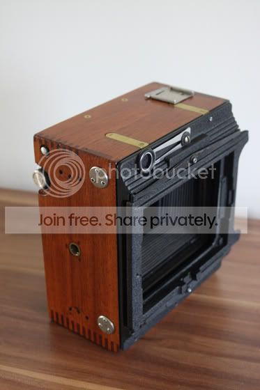

There are just a few random bits to do but there are some pics...
(The inside needs to be cleaned, I know!)

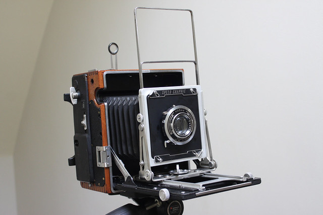

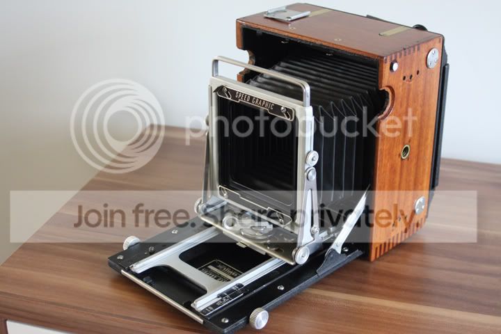

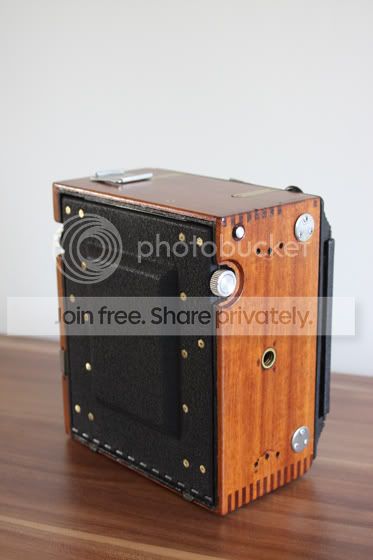

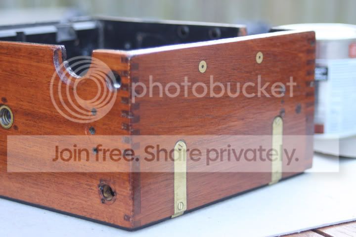

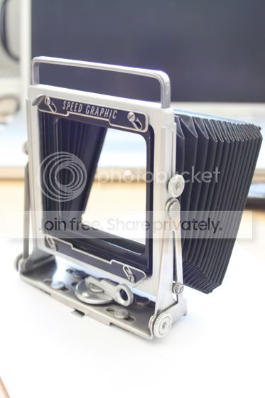

I managed loads today, rebuilt/polished the front standard, finished the final layer of varnish on the main body, rebuilt the drop bed and finished painting the rear standard...

They look great together and I will resist the pair joke, well done.

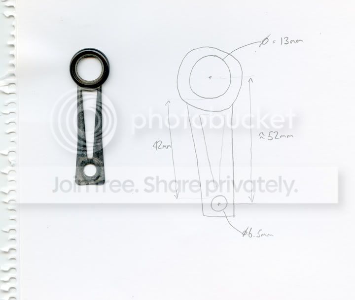

Very smart. any chance you could give me the dimentions of the rear eyepiece for the viewfinder, mine is missing and I want to make one up.
yep, that is the one. I tried taking a pic thinking 'my eye should be about here' where the little ring is... and I was miles off :). I'll probably just cut one from 2-3mm aluminium sheet. if you have access to a scanner could you put it under the scanner next to a ruler to give me an idea of scale.
thanks.
