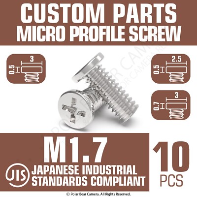

From a quick google, Canon use M1.7 x 3.7mm screws from the top under the spring plate.
Do you have screws below the plate? As it appears to be laying flat on the camera body I'm assuming their missing?
As above, it screws in place, and there’s a spring loaded pressure switch that might be missing too.
In short, it’s a simple fix, and there’ll be instructions on the internet somewhere, note that hotshoe isn’t unique to that camera, the design is ancient.
Edit: 2nd look, the switch looks intact, you just need the screws.
They are missing but I guess I can buy these
As @Sangoma has suggested, I think you'll need countersink screws as the plate is thin.
Hope you can find something.

The info I posted above was from a canon repair sheet but not a 90D, it was 5D III (but can't find it now).
