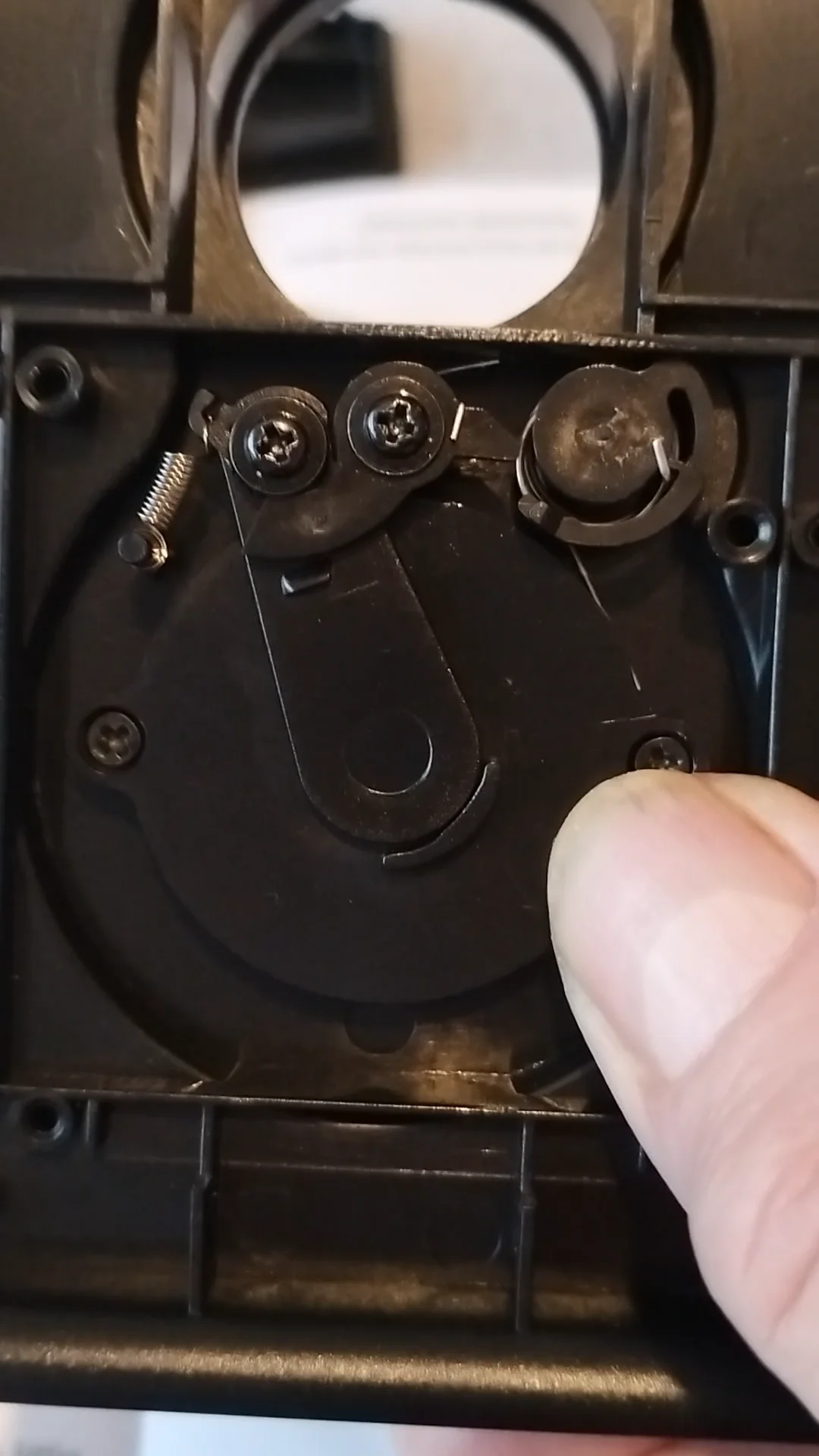

Tiny spring...
Some light profanity...and it's in.
So far it seems, as a kit, well designed. Magnetic screwdriver is a nice touch. 55 mins in so far. Part way through stage 3 of 7. Don't think you'll see any wet prints from this beauty tonight.
Edit: Time for a cup of tea. More camera excitement later.
Right back at it again. The part that takes the longest is the springs. They are now in. The pace starts to pick up a little mainly as the plastic sides start to go on.
Then 1st fail. Trying to slide in the large part (bottom left) and the small part (centre) falls out. About an hour spent this time so running at 2 hours. Right walk away and put the kettle on :(
Done, took about 3 hours total. Got the fallen out piece back in easily.
