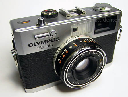

For the poketable variety, the easiest to get is Olympus RC ( and RD). Great little camera, great lens. Price 60-80£.
