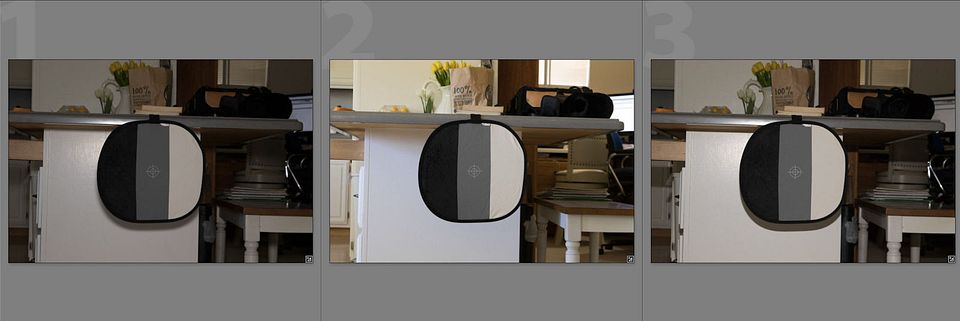

Canon ETTL flash does not work well with any softbox-like attachment, in spite of the fact that ETTL works well with un-modified head ceiling bounce!
Left shot is eTTL speedlight in small softbox (5" x 7" Wescott), center shot is ambient-only exposure, right shot is speedlight with no modifier.
The softbox shot is slightly underexposed, compared to the other two shots. FEC might help, but I have not tried in sufficient number of different circumstances to dtermine if eTTL flash has consistency of error.
