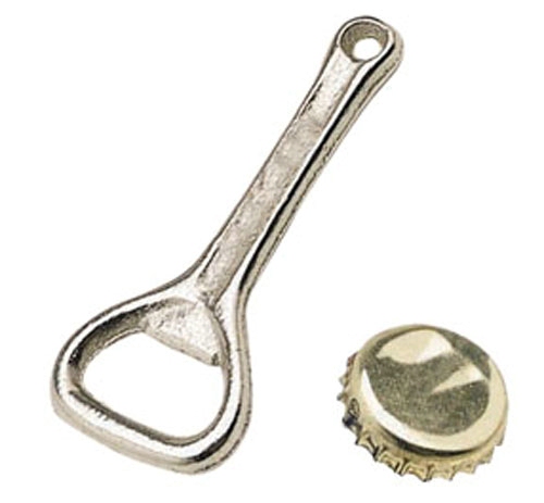

Bottle opener works fine. Open it from the bottom (i.e. the surface with the hole in the middle, not the surface with the nub sticking out) in the dark. Be careful - it takes a bit of force, but it should open up nicely.
I normally just push my thumb into the film slot and pull the can apart - it's really soft metal and they just peel open. Other classic way is with the old bottle-openers...
