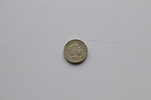

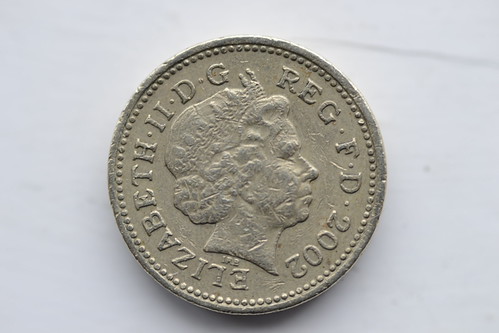

Might be worth getting a raynox m250 they cost about £40 quid on ebay
http://www.ebay.co.uk/itm/NIKON-D70...ography_Conversion_Lenses&hash=item3a856b43a8
50mm without
50mm with raynox
cheap way to do macro if your a cheapskate like me :)
